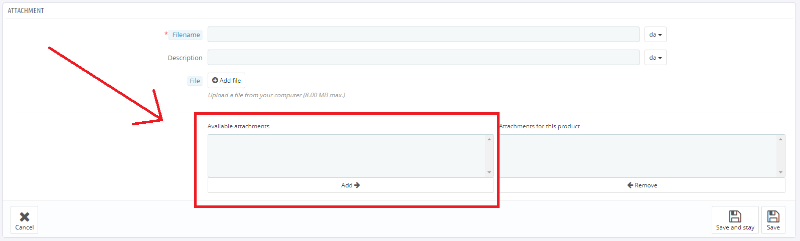

  • When i go to backoffice in Thirtybees 1.0.3 and upload an attachment in “Catalog - Attachments”, i am not able to find the uploaded attachment when i go to a product and would like to choose the recent uploaded attachment.
    If i dublicate a product with an attachment, the attachment disappears on the new product.
    If i try to upload the attachment manually in each product, it works fine.

  • Yes dublicates loses the attachments but the main problem is that attachments uploaded in “Catalog - Attachments” can’t be chosen afterwards in the products, which is a problem if you would like to use the same attachment for several products.
    The print screen in the top is an example of how it looks when i edit a product and would like to choose an attachment i already have uploaded, then i can’t find the attachment.

  • Thanks for the responses and i am sorry if I was not as detailed as I could have been. To reproduce:
    1. Create an attachment document using: Catalog ->Attachments -> Add new attachment
    2. Create a new product using: Catalog -> Products -> Add new product
    3. Save the product
    4. Attach the document created in step 1 above
    My Outcome: The attachment created in step 1 is not visible and so cannot be attached
    Sometimes it is visible for the first product created but not for any subsequent products
    Thanks
