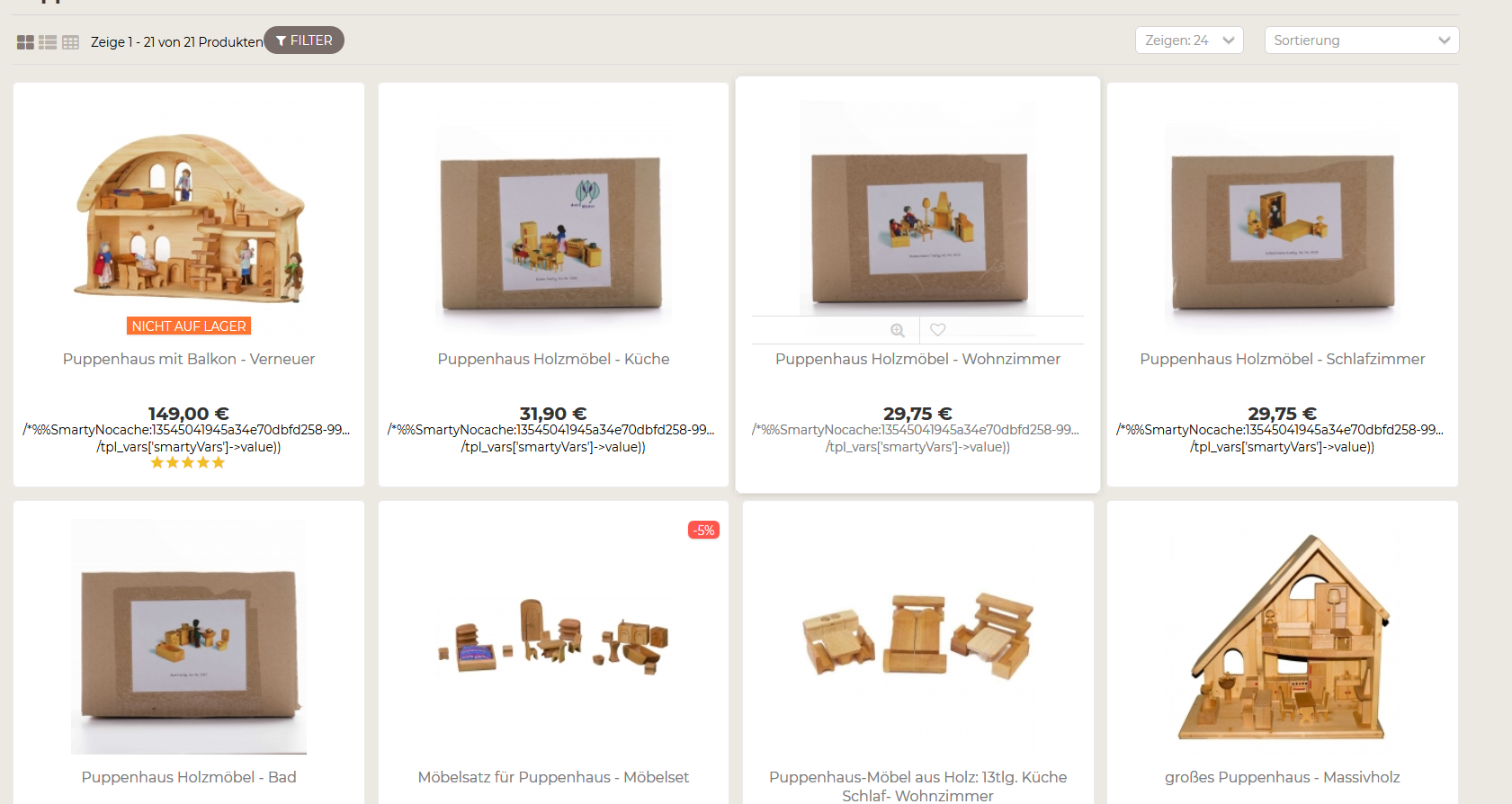

  • The whole day I could not reproduce this error. I did not dare to post since I was sure I did correct testing yesterday.
    Now, ca. 20 hours later the error appears on my desktop! I am using latest Firefox.
    I could see it on a subcategory.
    Funny thing is I just went to the mobile device and noticed that there all was ok?!
    I am giving up here since this is far beyond my understanding.
    FYI in order to reproduce the error I had today of course Smarty Caching ON (with no recompilation) and APC caching with Page Rendering.
    Only setting Smarty Cache OFF and clearing the cache in TB/performance made the price fields (AEUC) look normal again.
    Bottom line.
    I am sure it is linked to AEUC. Why it could appear on my PC and not on the mobile smartphone this time is a mystery to me.
    I also know how to bipass this error by using {no smarty cache} tag in AUEC file.
    Also notable is that it did never appear on homepage.
    0_1513442271791_2017-12-16 17-27-38_Gutes Puppenhaus und Zubehör-Bio & Öko Spielzeug - Grünes Spielzeug.png

  • oh now i have seen your picture, this looks like the known error with AEUC, but it shows Smarty Variables in your shop. Sorry have not seen this before, but looks like the reason is the same as in the known error i have written about. Do you have changed any translations or files?!

  • Global Moderator
    Fact is I could reproduce the error now
    That’s good! Please open a Github issue with the list of steps to reproduce the issue.
    Maybe it sounds a bit snobbish to some merchants, but the way to go is still to identify issues one by one and to create a list of steps to reproduce the issue for each. Reports like “I’ve seen this a while ago” or “there’s something wrong” don’t help. The only way to get an issue solved is to help developers to reproduce it on their development installation. “Click here”, “Type that”, “look at this page”. Like teaching it to a child. Like magicians, developers might be in an entirely distinct environment, so they have to to configure their development shop to match yours. Other than magicians, developers can only fix what they see.
    Which means: if you see an issue, make a screenshot. This way developers can see what’s going on on your site. If you’ve found a way to make it going away, please report this in words as clearly as possible. If you know a way to reproduce it with a fresh installation step by step, you’re golden :-) And all this into a Github issue, please, one Github issue per issue found.
