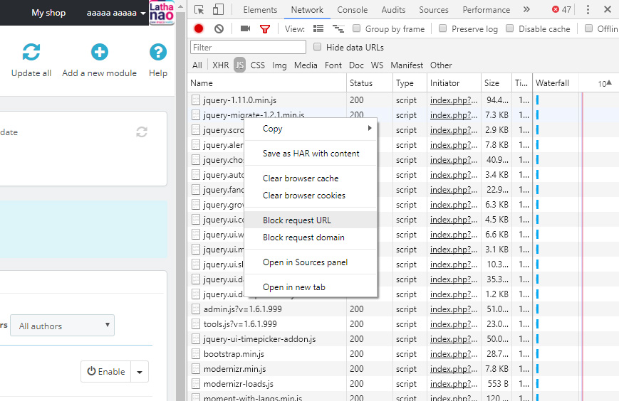

  • Hi,
    Another way, is to block assets you don’t want to load on your browser.
    Way to do in chrome: options panel (3 dots in top right) -> More Tools -> Developer Tools -> Network tab -> right click on what you want block -> Block request URL
    Resources will be block forever, no need to do it every time. Hopefully, you can unblock if needed.
    0_1517066538299_BlockRequest.jpg image url)
