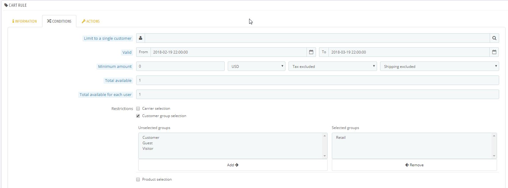

  • How to replicate the issue:
    1/ Create a customer group, for example HIGHVALUE.
    2/ Create or select existing user, add him to the HIGHVALUE group. Default group can still be Customers or HIGHVALUE, whatever you prefer the issue is the same.
    3/ Create a new voucher with valid dates and this condition: user being in the HIGHVALUE group.
    My action is a 5% reduction on order.
    4/ Go to the frontoffice and login as a user in the HIGHVALUE group. Try to order something and apply the voucher.
    I get the error: “1. You cannot use this voucher”
    This voucher was working in PS 1.6.1.17 and after migrating to Thirtybees it doesn’t work anymore.
    Other vouchers with other conditions seem OK. It seems related to the condition: customer group.

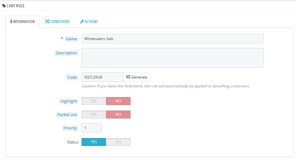

  • Well I have just tested again, created a new rule, same as yours, on 1.0.3, and it still doesn’t work. @smarterweb confirmed the issue on his side too.
  • Don’t know what to tell ya, works fine for me. I’m not sure what is causing the two of you to have issue with it. You might setup a test site, and check how it works on a fresh install, instead of on your migrated sites. Ive set up the voucher with and without a code, works fine both ways. This is on my production 1.0.3 site, and my test 1.0.4 latest source site.

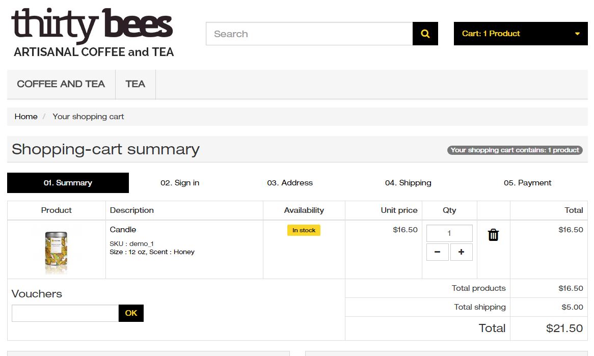

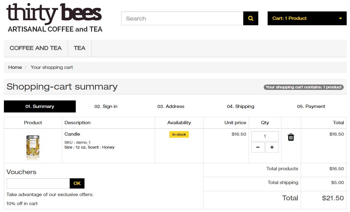

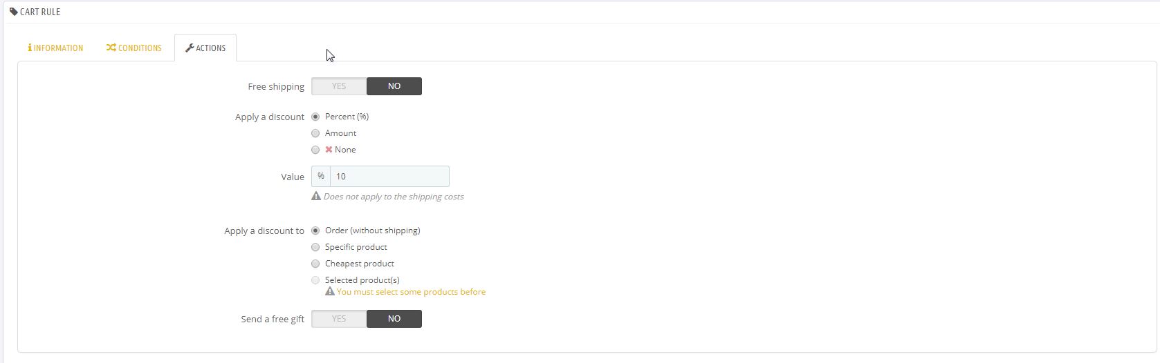

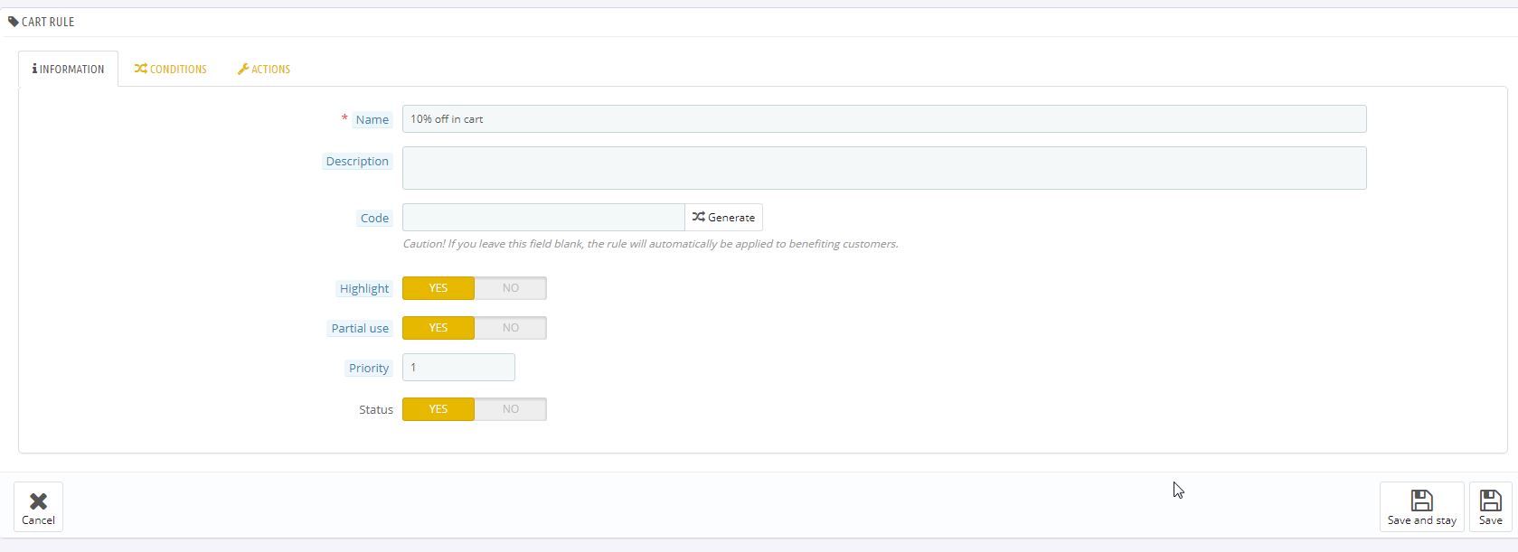

  • ok, just did a fresh install and yes I can still confirm this bug.

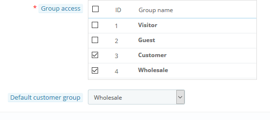

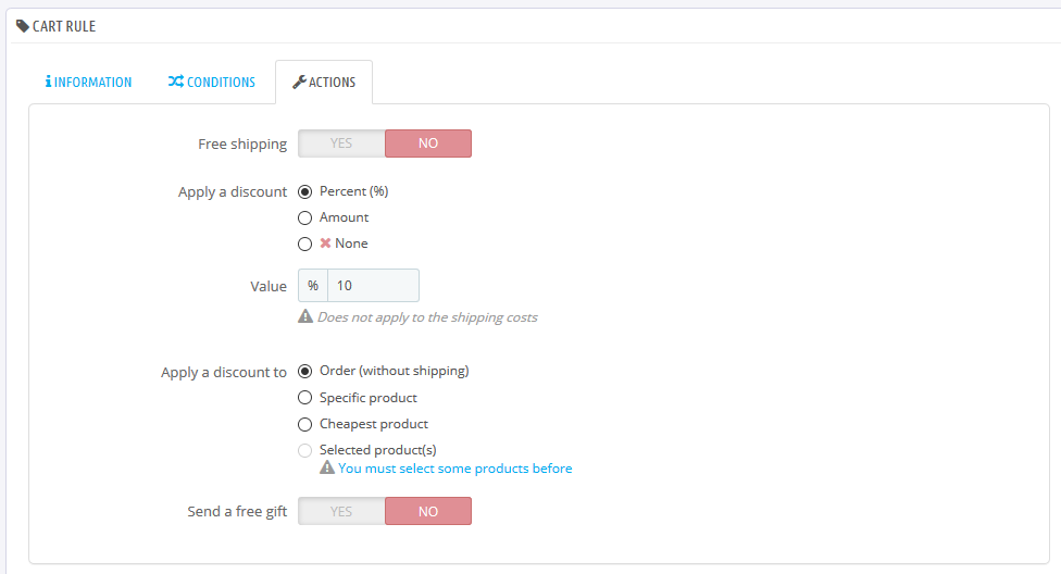

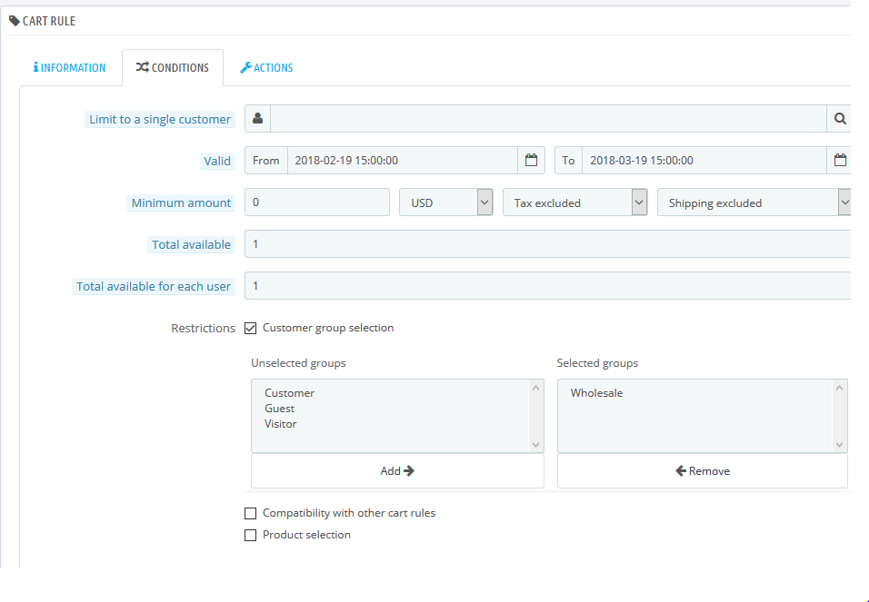

    the discount in my case does not get applied. when I choose “highlight” in cart rule, I can even see the name of the discount BUT it does not get applied. price is the same no matter if I switch the cart rule on or off.
    0_1519096634418_2018-02-20 16_16_33-Cart Rules _ Edit_ 10% off in cart • My Store.jpg
    0_1519096645002_2018-02-20 16_16_40-Cart Rules _ Edit_ 10% off in cart • My Store.jpg
    0_1519096649425_2018-02-20 16_16_46-Cart Rules _ Edit_ 10% off in cart • My Store.jpg
  • And it doesnt matter if you put the customer in the Retail group by deafult?
  • Are you guys using the same host by chance?
  • @slick_303 It doesn’t matter whether I set the default customer group or not.
