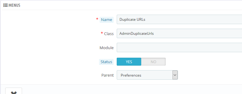

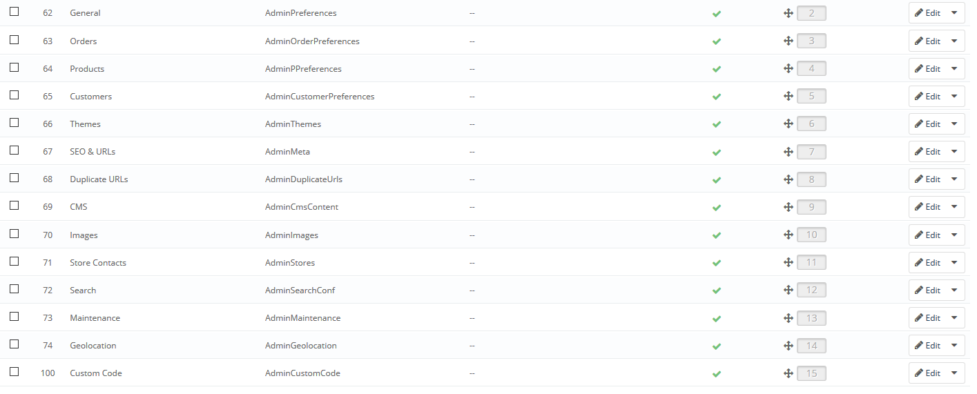

  • This is what the preferences menus look like in tb. Just make yours look the same… Goto BO>Administration>Menus, then add the couple you dont have (Duplicate URLs, and Source Code) . Click on the add new button, next to the refresh button on the topish right. Then in Name type in Source Code, then in class, type in AdminCustomCode. Do the duplicate URLs the same way, looking at my image here.
    Here is Duplicate URLs for example…
  • Thank you! One more step fixed. Really appreciated.
