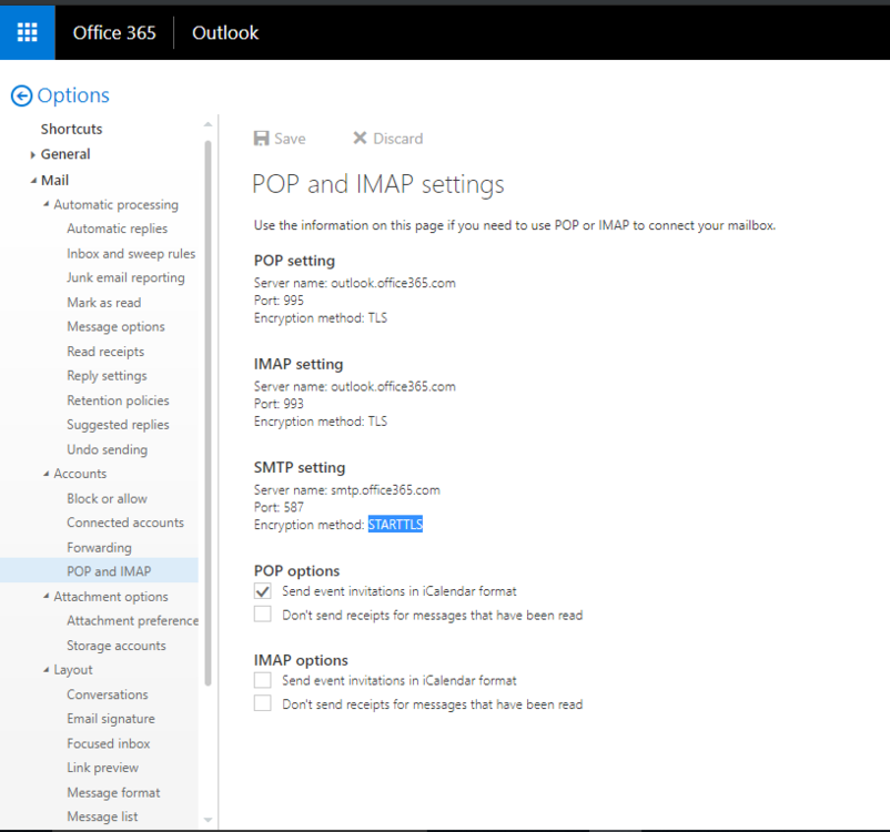

Okay, 1) I'm wondering whether 365 is just being fussy and looking for the STARTTLS over TLS? I currently have is set to TLS and 587 🙂
This is in my 365 settings.

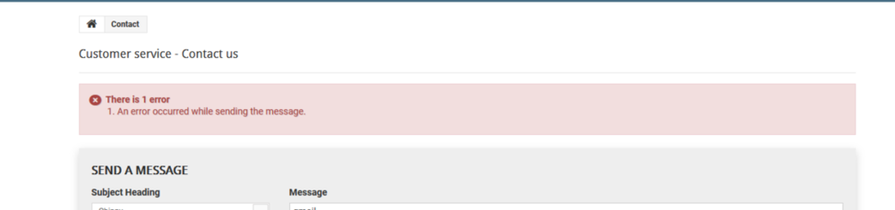

3) I have saved all the smtp settings including the password and at least for now the contact us page is coming up with an error.
There is 1 error
  1. An error occurred while sending the message.
So, that's actually good news for the minute, at least it's not telling customers it's submitted fine like it used to 🙂

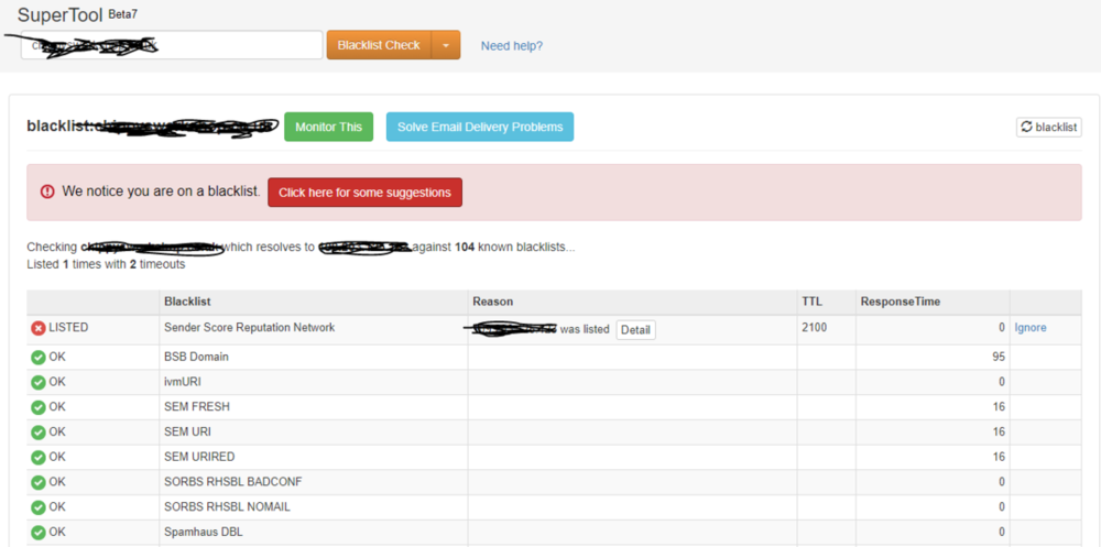

Blacklist check came back with 1?
Edited by t4Chippy

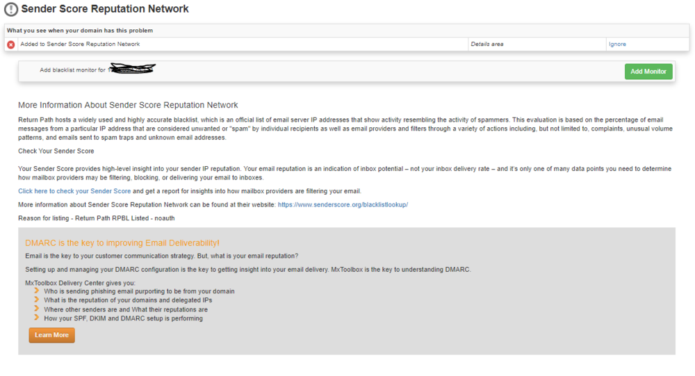

Here is some more info on that blacklist.
You might want to try checking your IP's sender score. There's a good chance they won't have much info on you, but they might.
Good that your domain doesn't seem to be blacklisted, that would really suck. Changing webserver IPs is much easier than changing domains.
