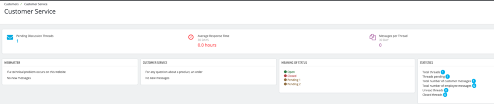

Ah, no, deffo not there, only messages there are ones the customer has added when they've ordered 🙂
I can see the email in Advanced perimeters > Email though
it means PHP IMAP is not installed on your server
in cPanel WHM it will look something like this
Easy apache >php extensions search IMAP.  Your server mate can check it out.  it just needs to match whatever version of PHP you have installed 7.0, 7.1 or 7.2
ah okay, so nothing to do with the problems I'm having, I always reply with outlook anyway 🙂
