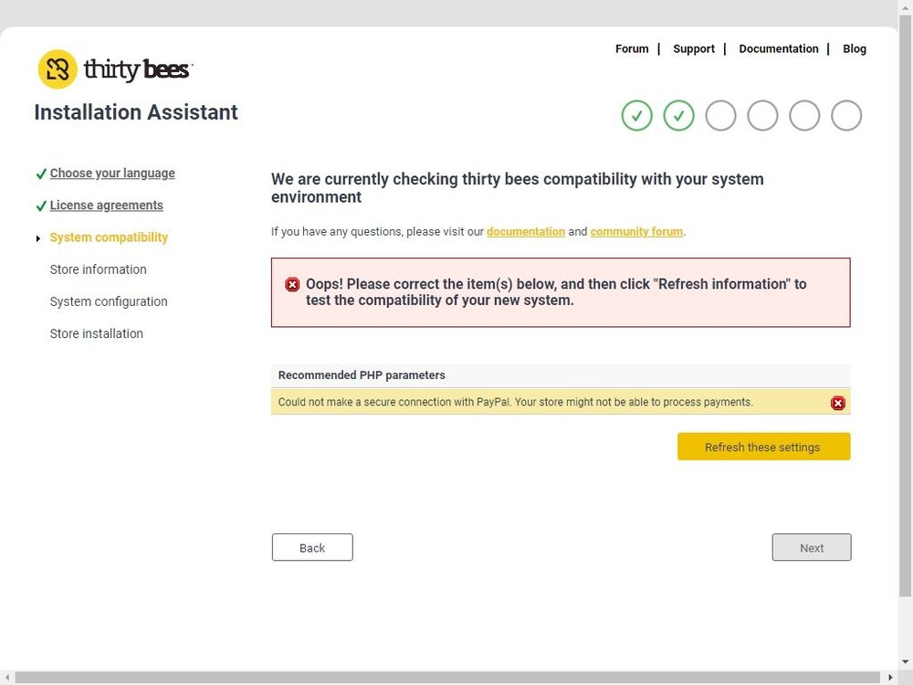

Recommended PHP parameters Could not make a secure connection with PayPal. Your store might not be able to process payments.
veganline
I'm installing and get the error message "Recommended PHP parameters Could not make a secure connection with PayPal. Your store might not be able to process payments." as on the screen shot.
I don't want to use the paypal module but can't see how to remove it at this point or make it work.
I have checked php settings to match suggested ones on a small server that managed to host prestashop 1.6.
The secure server is from cloudflare.
How can I carry-on installing? - answers appreciated.

I'm still stuck on the detail although I'm sure that's part of the problem.
If I click "next", nothing happens.
If I search the TB1.1 files for "paypal", I find nothing relevant - no paypal module in the modules folder for example.

I should post in the installation forum. Yes; it's the "Refresh" that doesn't work for me. As it is, I press refresh and the page code still says <input id="btNext" class="button little disabled" type="submit" name="submitNext" value="Next" disabled="disabled" />

PHP Warning:  call_user_func_array() expects parameter 1 to be a valid callback, class 'ConfigurationTest' does not have a method 'testTlsv12' in /home/veganlin/public_html/x/classes/ConfigurationTest.php on line 168
So I need to fool the code into thinking that a proper test has been done, or find some other way to stop it disabling the "next" button. Any help appreciated as I am probably too old to return the favor in bed cheers john PS Experimenting, I somehow got another error message that looked quite helpful, once. If I knew how to get more like this I could probably solve the problem myself. I don't remember what experiment it refers to, but it goes like this: [27-Sep-2019 18:03:06 UTC] PHP Fatal error:  Uncaught Error: Call to undefined method InstallModelSystem::checkOptionalTests() in /home/veganlin/public_html/x/install/controllers/http/system.php:83 Stack trace: #0 /home/veganlin/public_html/x/install/classes/controllerHttp.php(197): InstallControllerHttpSystem->display() #1 /home/veganlin/public_html/x/install/trystart.php(34): InstallControllerHttp::execute() #2 /home/veganlin/public_html/x/install/index.php(56): require_once('/home/veganlin/...') #3 {main}   thrown in /home/veganlin/public_html/x/install/controllers/http/system.php on line 83 [![Untitled.jpg](//forum.thirtybees.com/applications/core/interface/js/spacer.png)](https://forum.thirtybees.com/uploads/monthly_2019_09/Untitled.jpg.59760fda0ceb56b2ed379b02a00905a2.jpg)

Thanks for the idea! Same result though: if I comment out line 128
// 'Tlsv12'          => false,
I get the same result as when I put-in the fake test result, which is "please correct the errors below" but no errors.
Oddly enough the code mentions this being an optional test.
Is there any way I can learn more about diagnosing and bug-checking?
It looks as though something other than the Tlsv12 test is not working, maybe on my server.

Got it. @veganline kindly gave me access to the server.
The TLSv1.2 message is a red herring. Test fails, but it's an optional test, which doesn't prohibit installation.
Actual issue was a missing error message. The test for ensuring PHP's fopen() takes URLs failed, but didn't report an error, because there is no matching error message. Setting allow_url_fopen in php.ini to 1 should allow installation. And I'll add the missing error message to the sources, of course.
