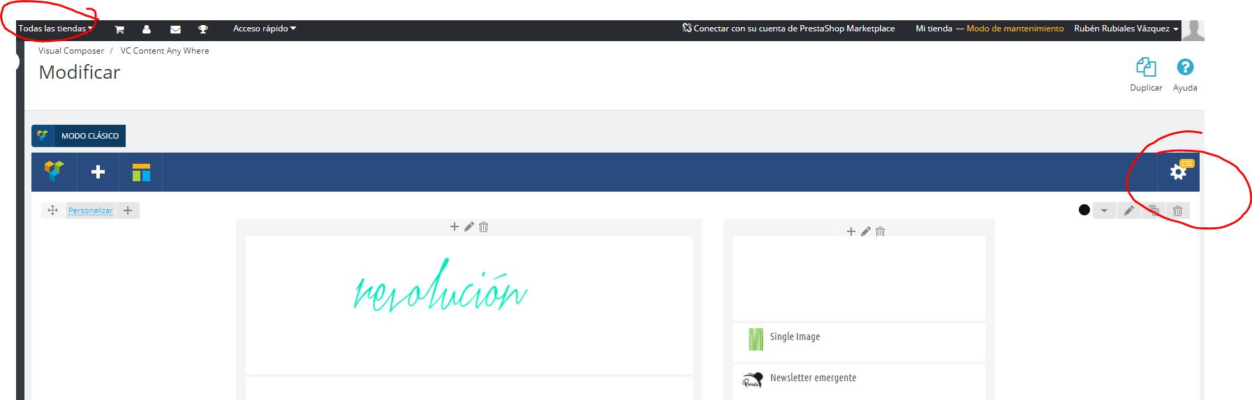

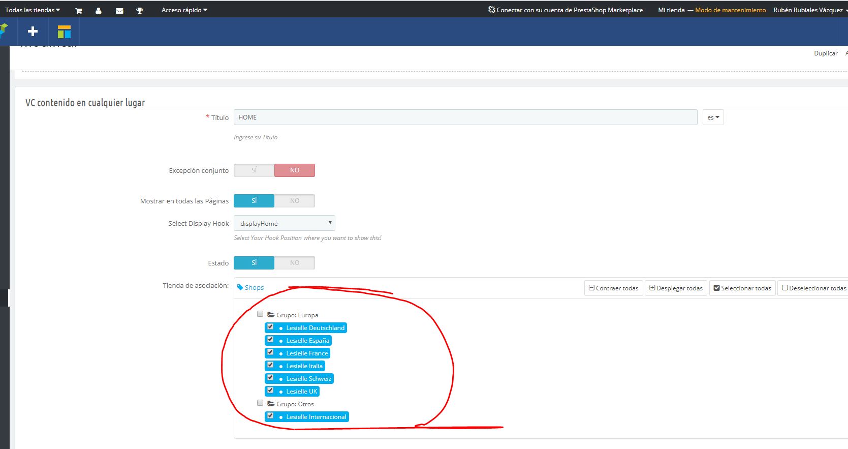

  • 1 more bug
    JUST IN HOME (in cms it works fine)
    Custom css doesn´t apply to all selected shops in multistore when saving:
    In this example you can see how I selected all stores in prestashop top bar and also in the down part of backoffice VC editor.
    @mdekker, any news from smartdatasoft in some bugs correction? (you said you are collaborating with them in corrections)
