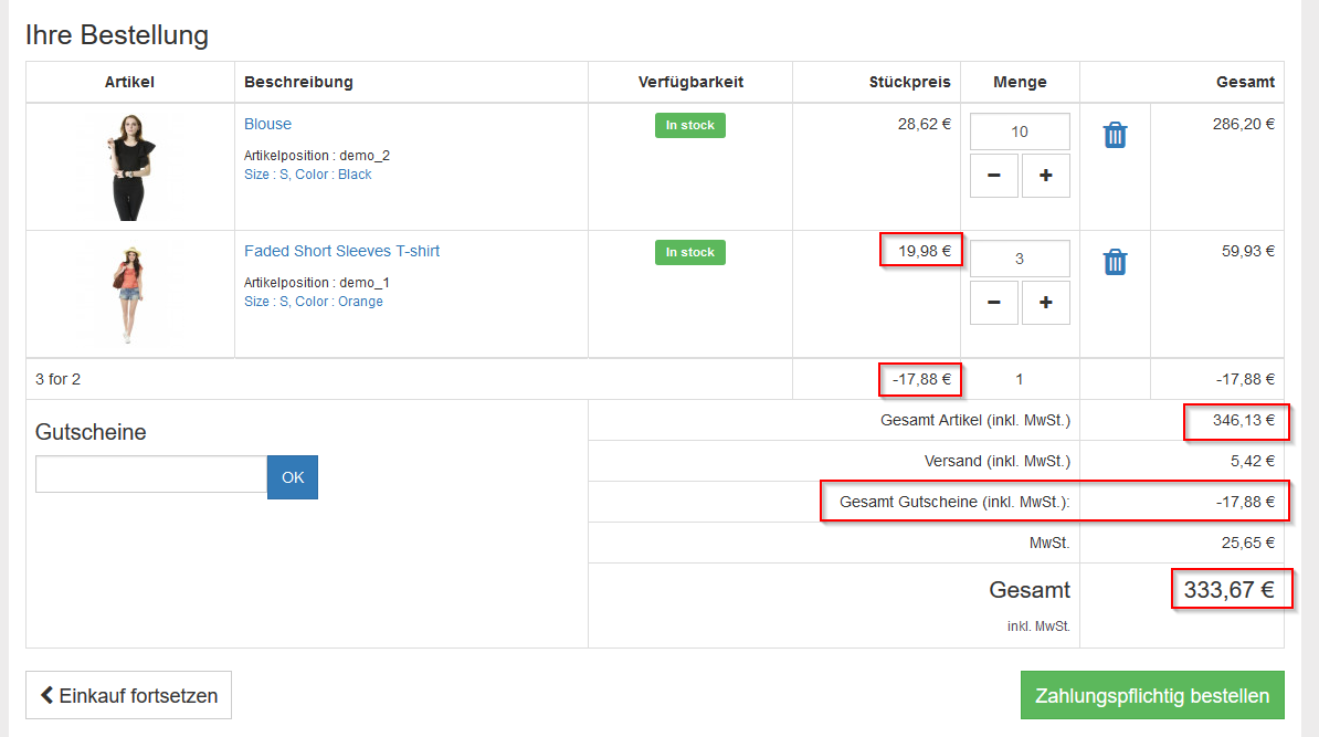

    1. Shopping cart in checkout
      Discount, net totals and totals are wrong

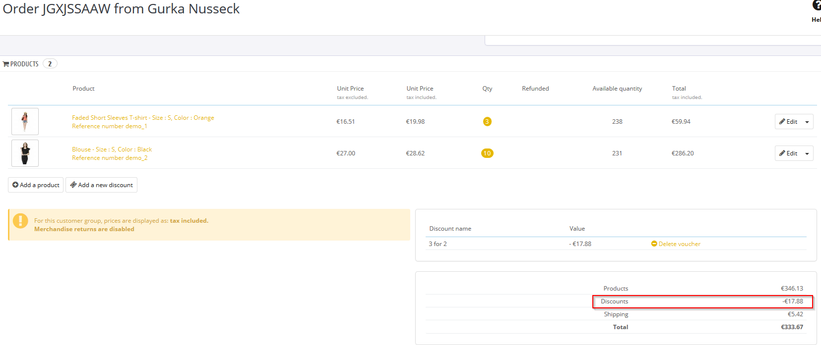

    2. Same in BO order page
      0_1499417067571_2017-07-06 18_59_21-Orders _ Order JGXJSSAAW from Gurka Nusseck • TB BO1.png

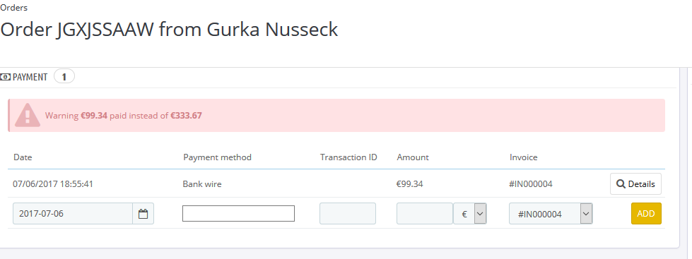

    3. Further bug in these “mixed” orders: Payment of previous order is “accepted” when you change status to paid, which causes a WRONG warning
      0_1499417091955_2017-07-06 19_00_05-Orders _ Order JGXJSSAAW from Gurka Nusseck • TB BO2.png

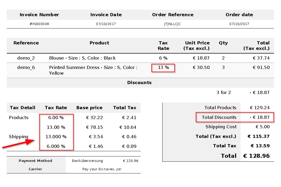

  • Made some tests. I’m not sure if this is what you really wanted:
    1. (Average?) tax for products discounted
      Order is computed with a tax rate 13% while the tax in fact is 21%
    2. Same on invoice:
    3. The cheapest product of all ordered products is discounted, no matter if it’s part of the action or not.

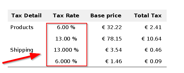

    4. I had my reasons when I convinced the PrestaShop team to show the tax rate without decimals in tax details. I’m sorry, but in my view this change in OrderInvoice.php is not a real improvement, but a step back:
      You replaced
      $rate = sprintf(’%.3f’, $row[‘tax_rate’]);
      with
      $rate = number_format($row[‘tax_rate’], PS_PRICE_DISPLAY_PRECISION);
    And btw it looks rather unformatted:
    Strange, that must be a template problem. I could have left an extra 0 in it.
    This was problem in former releases of PS 1.6.1 One fo the reasons why it was changed to a rate without decimals.
    Taxes can be entered with three decimals (both db and admin pages handle it like that), so we should format all the percentages like that, I guess. number_format is basically the same function, except it’s a raw PHP function rather than a ported C one.
    *Ok, no problem for me.
