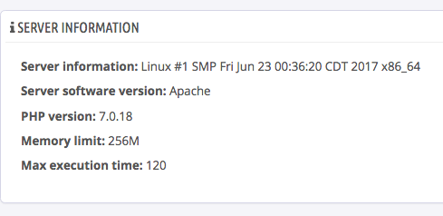

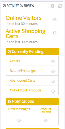

  • Turned off demo mode that showed all the demo stats now they all keep spinning.
    Is this a php version issue? Not sure if this is a bug or operator fault :)

  • I have the same problem. When I switch demo mode off dashboard (Activity overview) is spinning and spinning forever. There are just 88 (testing) orders, 40 products … in my TB.
  • administrators
    Did you disable one of the dashboard modules? It just occurred in my own store and I noticed that the dashboard.js script is lacking a decent check to see whether the targeted module has even been enabled. It is solved here after checking for the module’s existence before trying to invoke the module.
  • administrators
    Just noticed the “Dashboard activity” module (dashactivity) could use a few changes as well. Please try to update this module to version 1.1.2 and check if that solves the problem.
  • It has solved the problem. Thanks a lot. :-)
