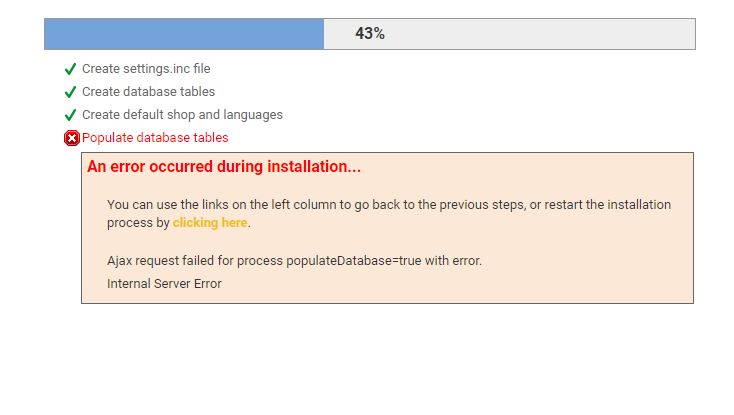

  • I’m dumb but I can’t get past this?
    On inmotion shared business hosting.
    Database connects fine.
    I believe permissions are fine
    Database user permissions are definitely correct.
    Would install via softaculous but they apparently removed the script, even though they say they didn’t.
    Any idea where I begin to fix?
  • Hi!
    I have the same problem when I try to install PS 1.7 on PHP 7.1.
    But on PHP 7.0 install was finished successfully.
  • Seen the random error we still have with PHP 7.1 on Travis, I think PHP 7.1 should still be considered unstable.
  • Thanks. That helped actually.
    Just installed completely fine with php 7.0.
  • PHP 7.1 has been getting more stable though, but I would still advise to be careful.
    I have recently switched to 7.1.10 in production, just to keep up with the latest developments and see how it goes, but I have been receiving lots of downtime messages. I’m still trying to figure out if it is related. In the error logs I can see that the PHP process just dies during the processing of a request, so I’m afraid that 7.1 is still not ready for production.
  • I identifyed the problem with same error of this, but in my case crash in create default shop and language.
    In my case when I try install with other prefix of tables dont tb_ result in crash, when I install with prefix tb_ installation work great.
    Try install selection other prefix to tables per example shop_ (Test in localhost)
