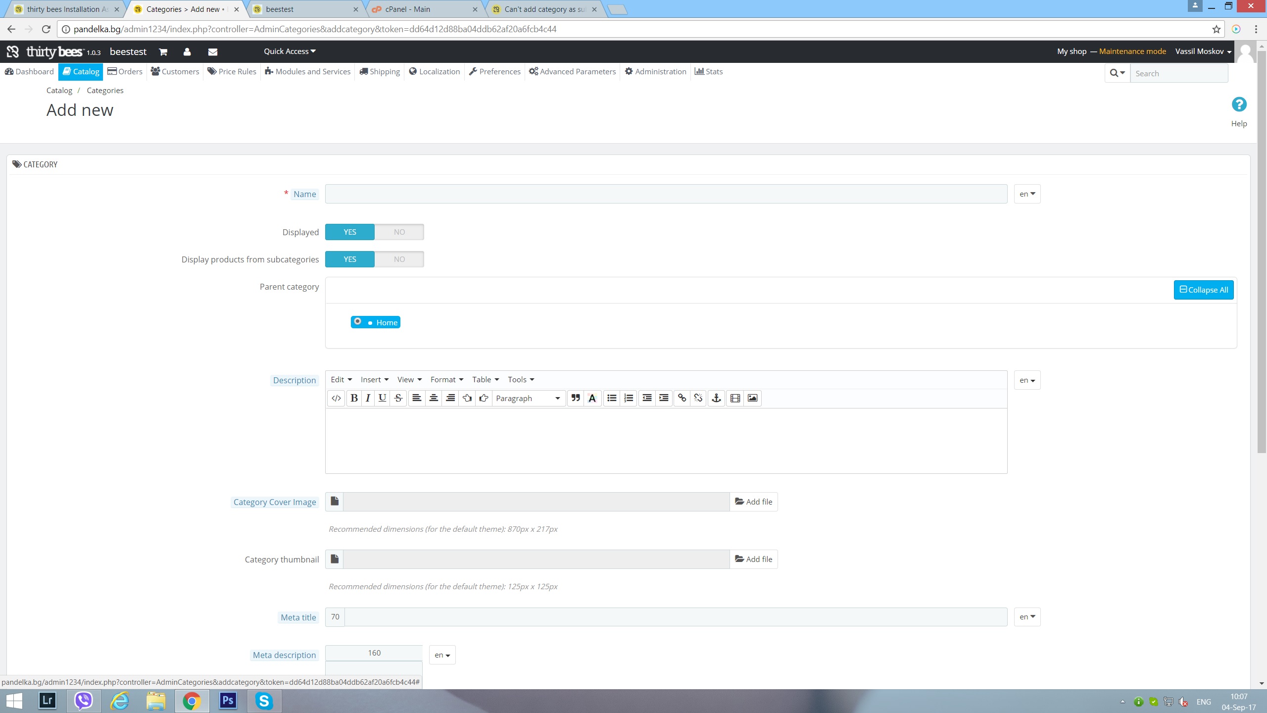

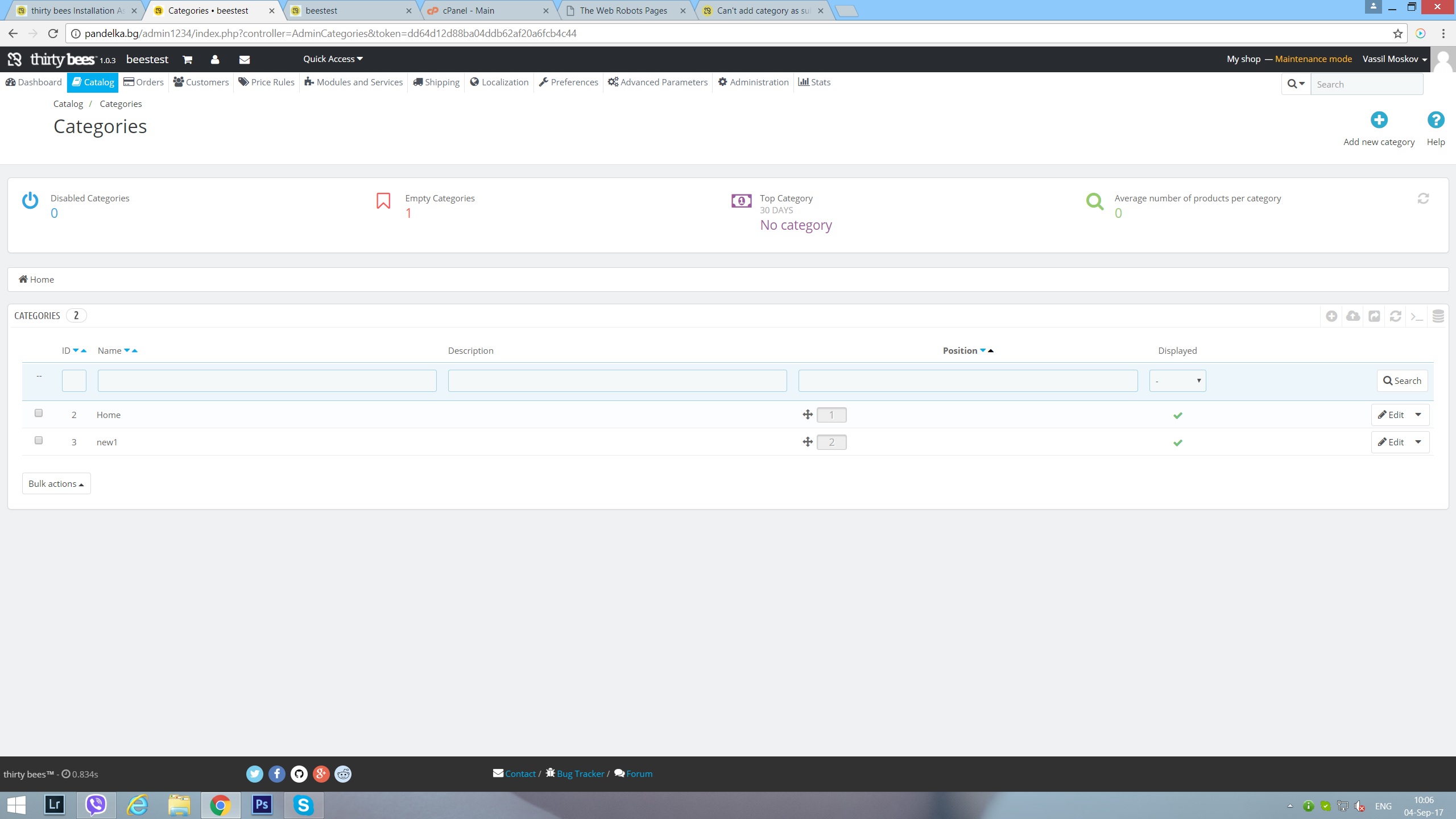

    I just made clean install of thirty bees 1.0.3 without demo products. Changed the view of the back end theme and added a directory called new1. After that on the main category menu I am able to see Home category (which I don’t usually see) and when I try to add another category and make it sub, I can’t expand the tree.
    Those are all the steps I did, so if anyone has any suggestions is welcome! I can’t believe I am the only one experiencing that issue, it is at least 4 clean instalations with or without demo products and same behavior every time. If anyone believes can help with solving the issue please write me message to give you access to the server and backoffice!
    Here are pictures with the home category listed and the “expanded” category tree.
  • @MockoB I think I located the bug.
    When there are no categories at all, if you click on the expend all button if will get broken ajax result, which cause the bug the you are experiencing, due to the fact that the return ajax result will change the category tree input name from id_parent to something else and because of that the controller will create a root category instead of regular category with Home as parent.
    Basically if you work as usual and won’t click the expend button (before adding a single category) you should be fine.
