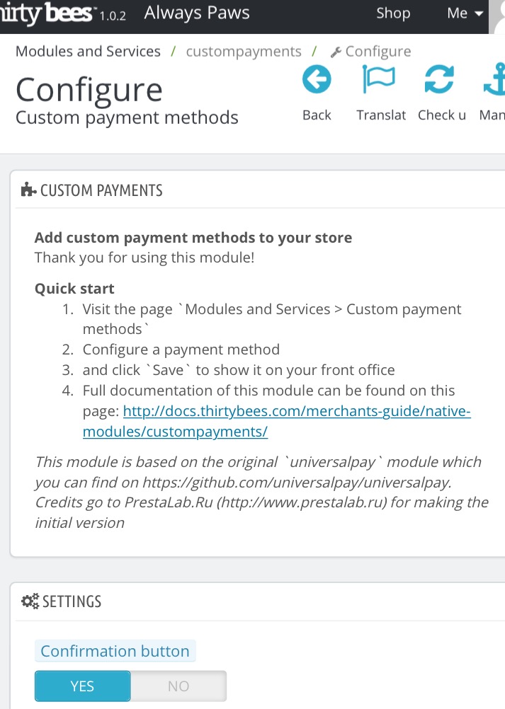

  • @alwayspaws , i installed this module through Thirty Bees admin back office. Not sure what you mean by seeing anything different.
  • This post is deleted!
  • @alwayspaws , this is just the config screen of the module. adding new payment method is through another menu item which is newly available after you installed the module. did you go to “Modules and Services -> Custom Payment Methods”? from there it is to add at least more than 1 payment method and i get the issue that i mentioned in the 1st post.
  • I did go there and I was right back to the screen that I showed you. In any case I don’t need this but I’ll watch it. I did this so you would get attention to your post.
