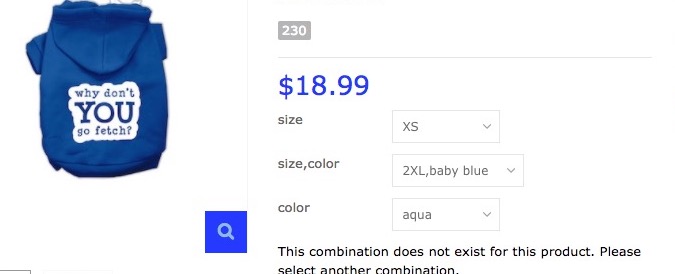

alwayspaws Posted October 11, 2017 Author Posted October 11, 2017 @jnsgioia Helllo! Which way are you saying is right? Did you look at my screenshot of the two exact same products uploaded with the exact same file two months apart and they have different results?

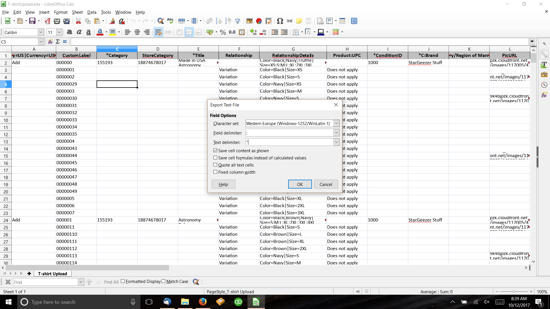

alwayspaws Posted October 12, 2017 Author Posted October 12, 2017 @DaoKakao :) How could I be angry with my good friend? :) I have only finally felt comfortable with csv's one month ago. I found my original openoffice calc .ods file that I uploaded in July and made a copy to test it now, as @jnsgioia suggested. I'm trying to convert the .ods to .csv with field delimiter of semicolon and text delimiter of a comma.
alwayspaws Posted October 12, 2017 Author Posted October 12, 2017 @jnsgioia @DaoKakao Here are the results of importing the original csv for the same product today as back in July 2017. I included .csv and screenshot of product which shows that the correct and incorrect display of sizes and colors attributes TODAY, after uploading the attached .csv. Thank you very much for your suggestion @jnsgioia 015078210342086-7-17-products-testing-on-10-12-17.csv New screenshot of same product incorrectly showing sizes and colors available selections:

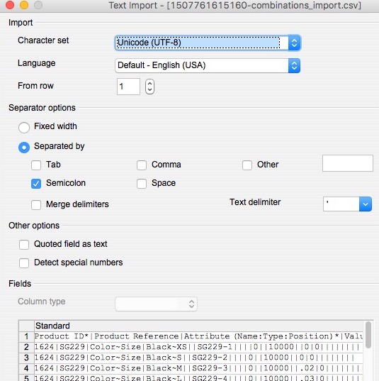

jnsgioia Posted October 12, 2017 Posted October 12, 2017 @alwayspaws open it with | as the separator. You will need to put it in "other"
alwayspaws Posted October 12, 2017 Author Posted October 12, 2017 @jnsgioia said in How do I use a csv import for a large amount of colors & sizes for a single product?: @alwayspaws open it with | as the separator. You will need to put it in "other" You came on just in time because the latest suggestion did not work. It resulted the same way with both showing.

jnsgioia Posted October 12, 2017 Posted October 12, 2017 You either need to try the pipe symbol or a ; actually anything except a comma
alwayspaws Posted October 12, 2017 Author Posted October 12, 2017 OK @DaoKakao thank you. @jnsgioia I have tried several things. Thank you. If I don't use the comma it is not formatted properly.
jnsgioia Posted October 12, 2017 Posted October 12, 2017 btw, the libreoffice calc file I opened wasn't a tb one it was an ebay one, so don't pay attention to the content. I just wanted to illustrate the little save as box. :)

alwayspaws Posted October 12, 2017 Author Posted October 12, 2017 @jnsgioia said in How do I use a csv import for a large amount of colors & sizes for a single product?: btw, the libreoffice calc file I opened wasn't a tb one it was an ebay one, so don't pay attention to the content. I just wanted to illustrate the little save as box. :) No worries about that! :) Let me look now.

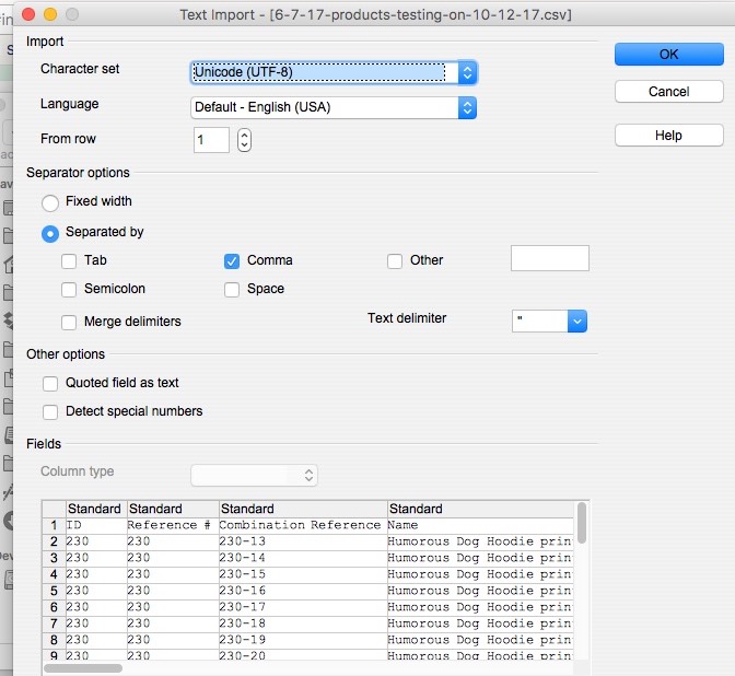

alwayspaws Posted October 12, 2017 Author Posted October 12, 2017 Settings available with openoffice calc:
