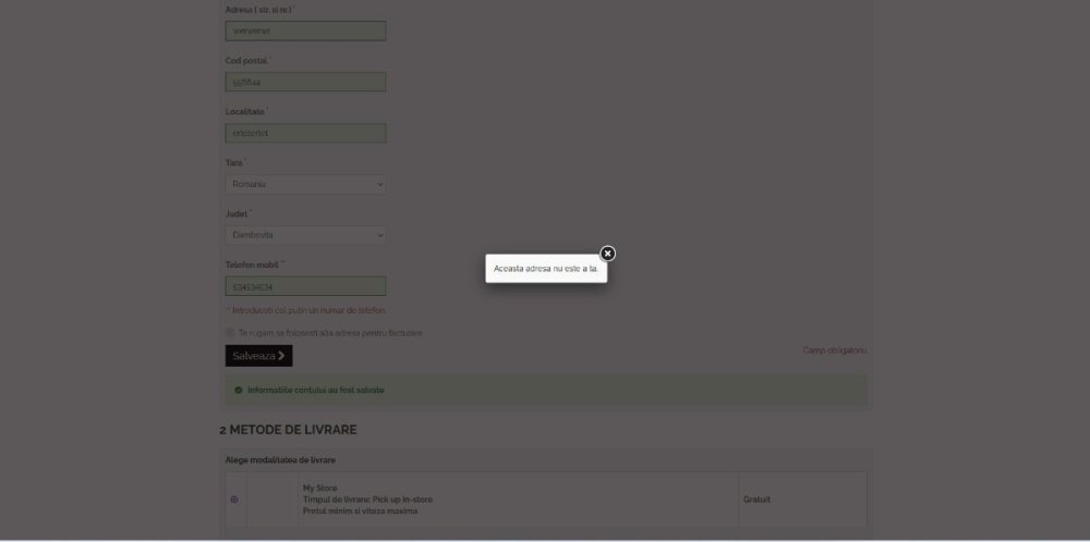

  1. Thank you for sharing that info, I did not know that. But with all caches I was able to find deleted, no litespeed cache enable, fresh install, no modules installed, and this problem appearing only for one page checkout and works fine for 5 steps standard , it seems to me that this is not a cache problem. Anyway, I went to Preferences->Customers and change setting for Registration process type from Only account creation(default setting) to Standard (account creation and address creation) and it looks like it solved the problem. Interesting, for 1.4 TB version this problem never happens, I have stores in 1.4 that works fine with that default setting. Maybe this will be useful for you. Thanks
  2. From Performance Settings, Server side caching -> NO, so no Use Full Page Cache can be enabled . What do you mean by your server is displaying HTML content that was generated for different user Thank you
  3. Thank you for your answer. Nope, no specific settings. Just romanian locals, preferences (single page checkout, quick order activated), SSL activated, php 8.0, the rest are defaults. If you try on domain arts-online.ro pick a product, try checkout with quick order, write some data ( romanian zip code is six digits like 442266) try to save and there is. After some digging it looks like the problem arises al line 226 at OrderOpcController.php, but no php error was logged, as I was capable to find If you like I can sent you the credentials to have a look at backoffice, anyway this domain is just for test Thank you for help and advice Horia
  4. Hello friends Problem, here is: Fresh Thirtybees 1.5.1 installed at arts-online.ro. Locals for romanian package, settings, language, currency etc. Set for one page checkout, try to make an order without account (quick order). After completing the form when try to save, a message like "Aceasta adresa nu este a ta" this is in english "This address is not yours" like in picture attached. The client is saved in backoffice clients table. If I try to continue and accept conditions an error shows up, saying something like error address. It's annoying, because the client wants one page checkout with quick order. Please help Thank-you Horia

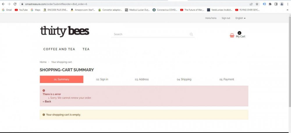

  6. Hello friends I have a fresh install of TB 1.3.0, enabled SSL, configure bankwire module, make am account, add address, make a command, everything works fine but when from my account try to reorder I get this message: Sorry. We cannot renew your order. It's pretty basic what I've done, original settings unchanged exept SSL and bankwire, no modules installed, what am I missing here ? It' happening on https://omastreasure.com Thanks a lot

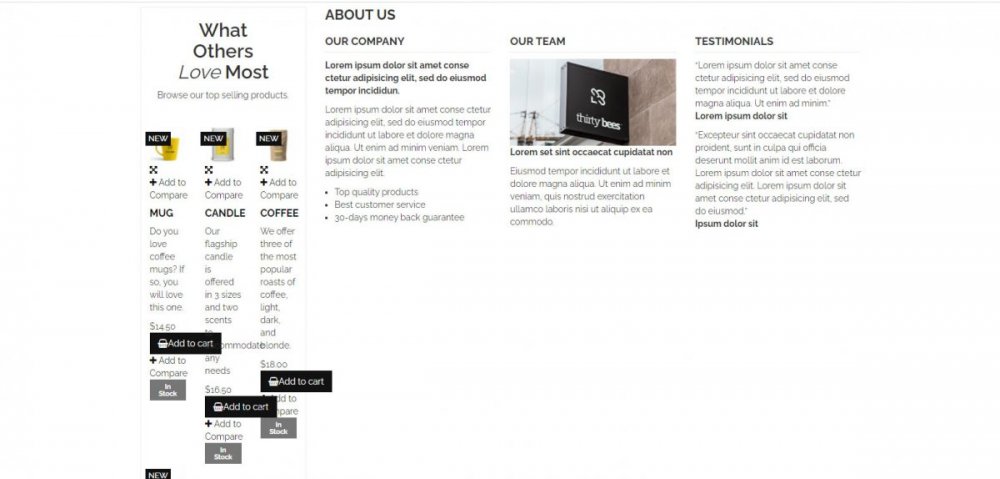

  8. Hello there New clean TB 1.3.0 install, and this is showing on about us and other CMS pages. How can this be corrected ? thank you
