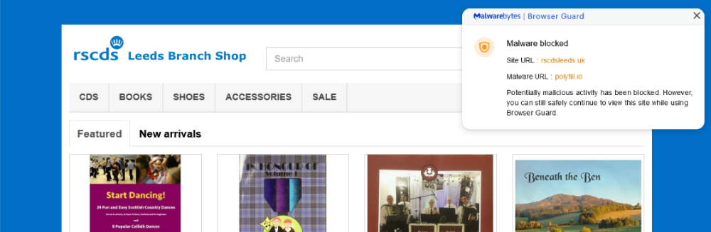

Just had a customer report the polyfill.io malware problem on my site. We're running TB 1.4.0 under PHP 8.1 I ran core updater ( 1.6.8 ) and it reported all OK. I checked header.tpl in the community theme and there's a reference to polyfill.io on line 62. Do I just have to delete this line as a quick fix? Anyone know what the above malware actually does?

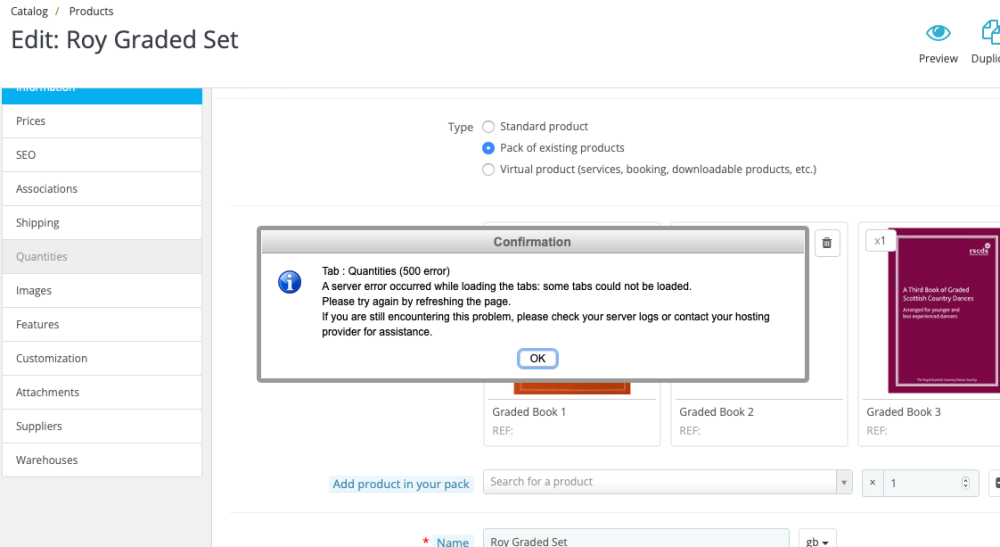

FWIW - after more investigation 1. Creating/editing a pack worked with Thirtybees 1.4/PHP 7.4 2. Creating a pack fails on Thirtybees 1.4/PHP 8.0 (see original post) system errorlog message [Thu Aug 31 12:15:06.678767 2023] [fcgid:warn] [pid 98599] [client 2.126.60.141:62483] mod_fcgid: stderr: Tried to use set_time_limit which is a disabled function, this is not allowed., referer: https://ashtonjones.uk/index.php exception log in Thirtybees log folder *ERROR* 2023/08/31 - 12:16:18: Error: Cannot use positional argument after named argument at line 665 in file classes/stock/Warehouse.php 3. Creating a pack of products with products NOT in advanced stack control works. As I'm running a system I ported over from Prestashop 1.6.24 I'm wondering if I'm looking at a Thirtybees problem or one that's specific to my service? So - setup test system from virgin 1.4 release and test data ( on a raspberry pi !! ) edited product to move them to Advanced Stock Management and created a pack. Seemed to work OK but as soon as I add the pack to my default warehouse I get the on screen error on clicking SAVE.
When creating a pack of existing products I get a Quantities (500 error) on clicking Save and Stay. See attached file. I can do this on my local server and get the failure when running at my ISP ( Fasthosts in the UK ) Checked the error log on the server and found an error ( see attached file ) which relates to a disabled function 'set_time_limit'. I assume this is a restriction set by my ISP but not sure if there's a workaround? This is the only time I've come across this error. Anyone any ideas? Thirty bees version: 1.4.0 PHP Build 8.0 MySQL 5.6.51

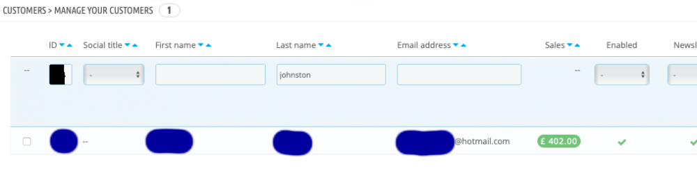

After migrating to TB 1.4 from PS 1.6.24 I noticed the Sales column in the Back Office Customer display was different from the corresponding Prestashop screen for a subset of customers. The TB total was greater than the PS total. After investigating I noticed the 'problem' customers had split orders in the tb_orders table. i.e. two or more rows with the same order reference. This means that there's a many to many relationship between tb_orders and tb_order_payment using tb_orders.reference and tb_order_payment.order_reference. I'm not exactly sure under what circumstances split orders are created in TB or PS. So is this a 'feature' of the database I've transitioned ( in which case I can live with it ) or does TB also create split orders under some circumstances? And if so will some totals also be wrong? As far as I can see this only affect the Back office displays.

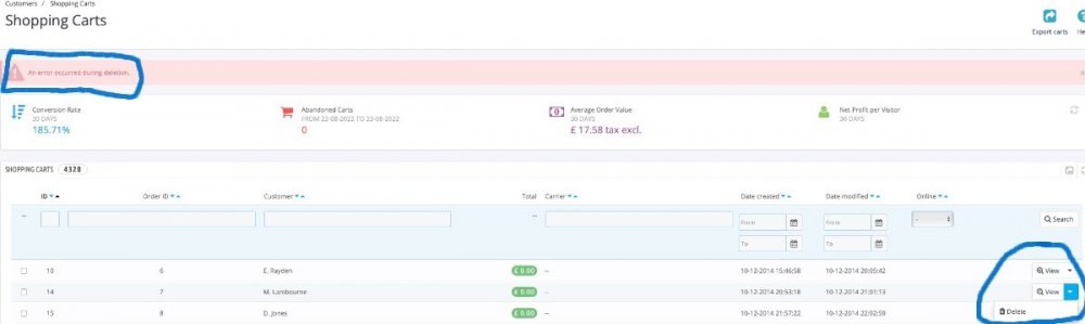

In Prestashop 1.6.24 ( and earlier versions ) it was not possible to delete Shopping Carts that have been converted into orders. Although the Customers/Shopping Carts screen in the BO gives a Delete option in the View dropdown clicking it displays Deleted Selected Item? in an alert box. Selecting OK then produces "An Error Occurred during Deletion" at the top of the screen. ThirtyBees 3.0 seems to have inherited this behaviour. I can't see the need to retain Shopping Carts which have been converted into orders. I've carts going back to 2014. The order details are still available. If there is some hidden technical reason? If there is why show the Delete option? As a test I've manually deleted entries for a customer in tb_cart_product and tb_cart - [ on a test server ] This had the desired tidying up effect but I'm wondering if I could have stored up some future problem?

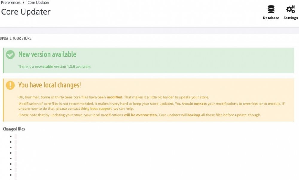

Starting out on my Thirtybees journey. Did a new install of version 1.3.0 Upgraded Core Updater to 1.6 Configured Core Updater and received Your installation is broken! We have detected some problems with your installation. You should fix them by updating your store. Changed files config/json/files.json modified vendor/composer/ClassLoader.php modified vendor/composer/autoload_classmap.php modified vendor/composer/autoload_real.php modified vendor/composer/autoload_static.php modified vendor/composer/installed.json modified Extra files vendor/composer/InstalledVersions.php vendor/composer/installed.php vendor/composer/platform_check.php I obviously haven't changed any files ( other than by running the install ) so Is this behaviour expected. Is it OK to continue with the upgrade -
