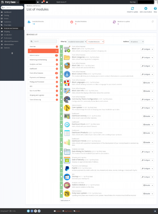

  6. I have just tested with 5.4.5 and I get the same error. I should also mention that I am using the one-page checkout, if you'd like to try to reproduce the issue Upgrading to bleeding-edge / 1.4 is not ideal, as the production environment does have a theme already developed and some overrides (though still no third party modules). But I will attempt the upgrade to fix the paypal module, I need the guest checkouts working. UPDATE: I have tested bleeding edge and the error happens there too. To recap: this happens on a clean install of tb, bleeding edge, no overrides, many default modules disabled, niara theme, one page checkout. It also happens on 1.3.0 and with PayPal module version 5.4.5. UPDATE2: provided screenshot of modules enabled I believe the module does something to the cart because the cart is gone, but it is not successfully transformed into an order.
  7. Ok, I am testing this on a clean tb install without any overrides. So you can take those out of the equation. As for modules, I am also not using any third party modules. Many of the ones that come with a clean install have been disabled too, as an attempt to isolate the problem. The log directory does not get any update, and the system logs in /var/log/php-fpm only report those notices. I don't know where this error is logged, if it is at all. Can you please help me?
