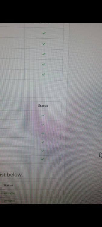

  1. It was something blocking the install in google chrome, I tried to install from Microsoft Edge and succeeded Your installation is finished!

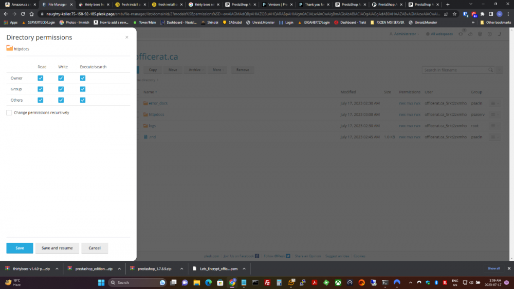

  2. I don't know of any other way to set permissions is this not enough to set them in Plesk for the entire folder?

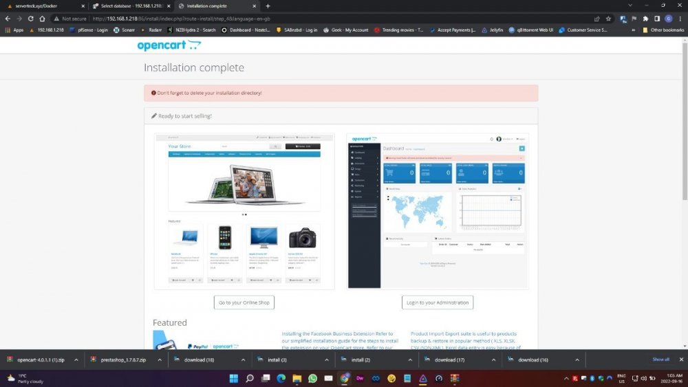

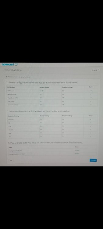

  5. I just figured this out too. I need php 7.4 but I cannot find any way to downgrade my NGINX. There was one very long day I spent 12 hours and then about an hour ago I realized that thirtybees won't support PHP 8 and I turned my attention to the one store that does. I wish I had known sooner I tried everything to install it. The solution is Opencart. It supports PHP 8 and it installed on the second try. I admit I didn't get it the first time around. I had to reboot and all that stuff and delete and cleanup my mess of installations from thirtybees first. With much regret I must leave thirtybees now becuase the world has moved onto PHP 8 and there is no longer any way to install it unless you rent a webserver and ask a professional to downgrade the PHP. I couldn't figure it out on docker. If anyone comes across this situation don't spend an entire day on it check your php version by typing php -v into console. root@cb248ccfb3c1:/# php -v PHP 8.0.18 (cli) (built: Apr 22 2022 22:53:40) ( NTS ) Copyright (c) The PHP Group Zend Engine v4.0.18, Copyright (c) Zend Technologies with Zend OPcache v8.0.18, Copyright (c), by Zend Technologies root@cb248ccfb3c1:/# Opencart is confirmed to support this php version. Goodbye thirtybees 😞 I will miss your forums.

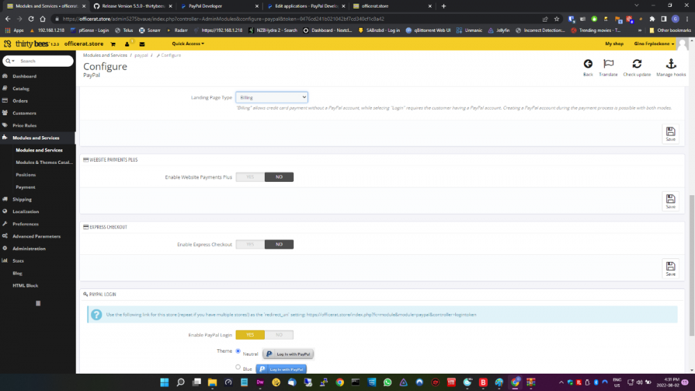

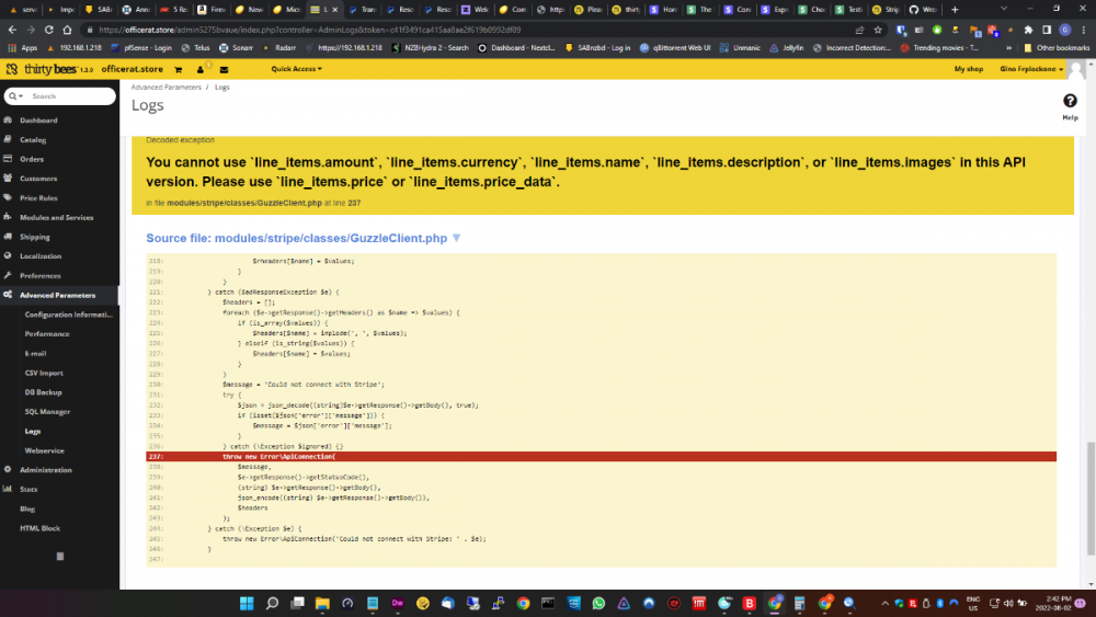

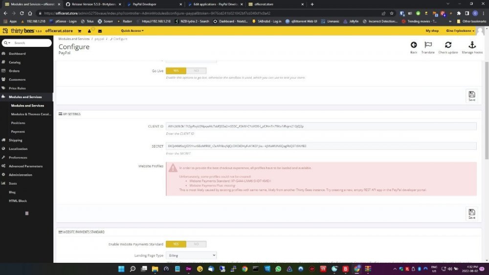

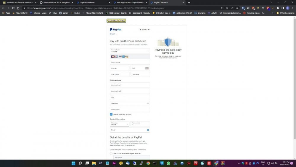

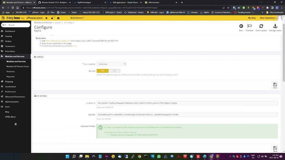

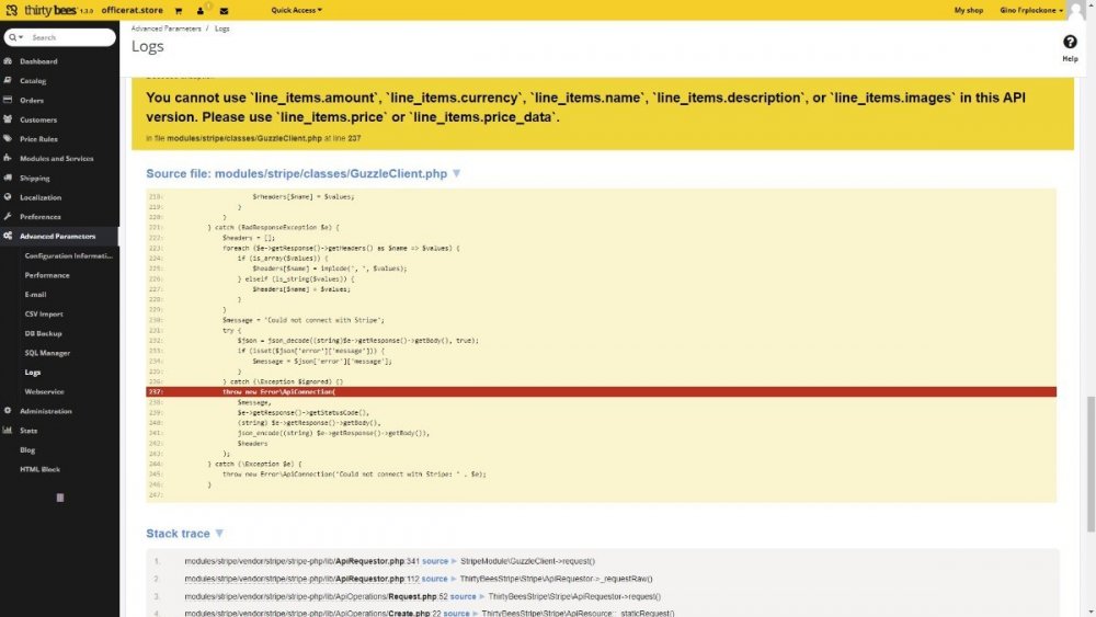

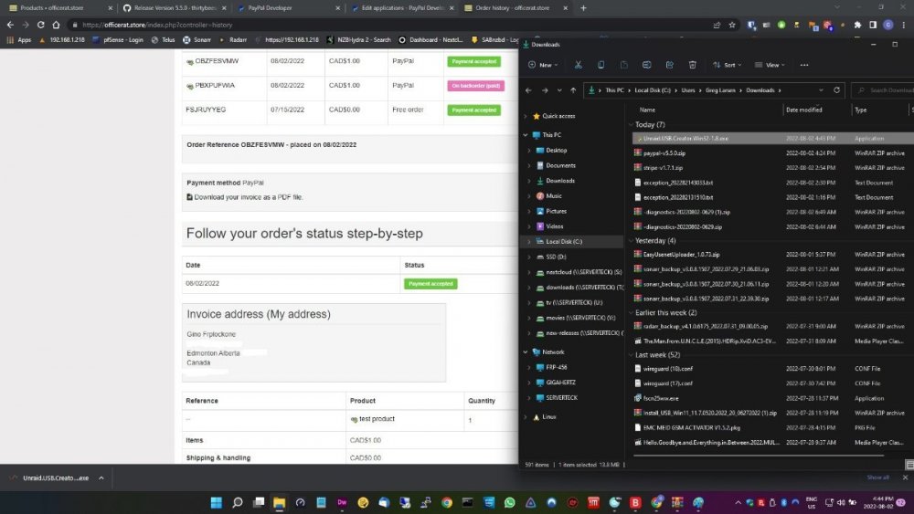

  11. Issue resolved after several hours of investigation. It turned out to be a bad stripe module, in fact if the stripe module is installed neither the paypal nor the stripe will work. I removed completely the stripe and i deleted the paypal as well and installed it from a different source, githubs repository, then I toggled the switch to disable all 3rd party non thirty bees apps on and off, created a brand new api through paypal and will use paypal for regular credit card purchases as well as paypal purchases. I discovered that there was two incorrect settings selected in paypal as well that were preventing the order from completing. I enabled website payment standard and this time I did not enable express checkout or website payments plus because they are not supported and give an error code which I overlooked before and did not notice but it was there. Now everything is peachy and order processes and product is delivered digital goods and downloadable and the order says that it completed. I will never install stripe again, how aweful that I lost $200 sales and almost two months past of people trying to place orders and no one bothered to message me and tell me that the checkout wasn't working. It was working at first but I only tested it with a free product and it really needs to be tested at $1 and I did this twice and all is working now. I can finally relax because I won't lose anymore business and money. I never will use stripe again, I'd rather buy the square module and try my luck with that however with it working properly I should just use paypal because it processes regular credit card purchases all the same. I just don't like how people open disputes instantly as soon as something isn't working and don't bother to message me and tell me there is something wrong. I never had a chance to fix it before losing money.

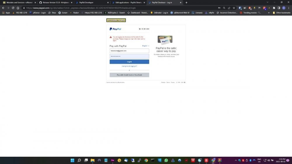

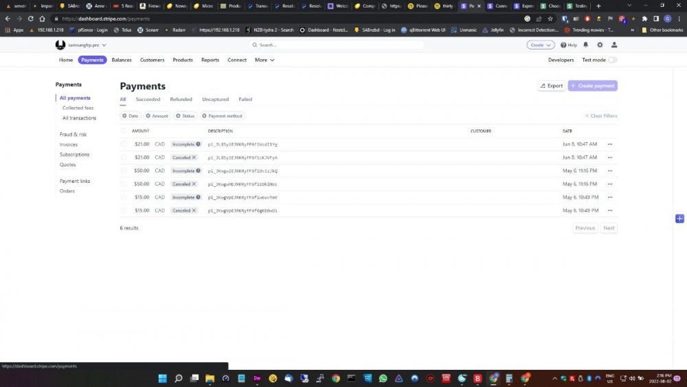

  12. I cannot test paypal because it won't allow the same account as who's charging the money to pay the money. I get a warning that I am the seller account and I cannot order through paypal with the same account. That is the entire error message, I am trying to get stripe working or anything working at this point any payment method is better than none. and yes there was a dispute for paypal it charged him then it said 500 server error and the order did not even register in thirtybees but the customer was charged for the item. In fact, I first heard about the dispute through paypal by email and I had no knowledge of the order at all until I emailed the customer who has since moved on and bought it somewhere else.

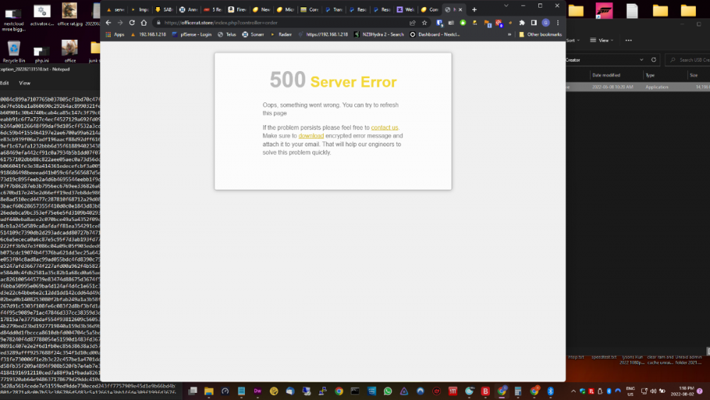

  13. My first customer ever received a 500 server error when attempting to place an order and now that paypal has charged him for the item and he never received it there is an open dispute. Please help me fix this 500 server error when placing an order as soon as I try to complete the checkout here is the encrypted error message. What can I do to remedy the situation? decrypted error message: $rheaders[$name] = $values; 219: } 220: } 221: } catch (BadResponseException $e) { 222: $headers = []; 223: foreach ($e->getResponse()->getHeaders() as $name => $values) { 224: if (is_array($values)) { 225: $headers[$name] = implode(', ', $values); 226: } elseif (is_string($values)) { 227: $headers[$name] = $values; 228: } 229: } 230: $message = 'Could not connect with Stripe'; 231: try { 232: $json = json_decode((string)$e->getResponse()->getBody(), true); 233: if (isset($json['error']['message'])) { 234: $message = $json['error']['message']; 235: } 236: } catch (\Exception $ignored) {} 237: throw new Error\ApiConnection( 238: $message, 239: $e->getResponse()->getStatusCode(), 240: (string) $e->getResponse()->getBody(), 241: json_encode((string) $e->getResponse()->getBody()), 242: $headers 243: ); 244: } catch (\Exception $e) { 245: throw new Error\ApiConnection('Could not connect with Stripe: ' . $e); 246: } I also tested the system and I received the same error message and am unable to place any orders. Im losing money, already lost $200 in payments not processing exception_202282131510.txt

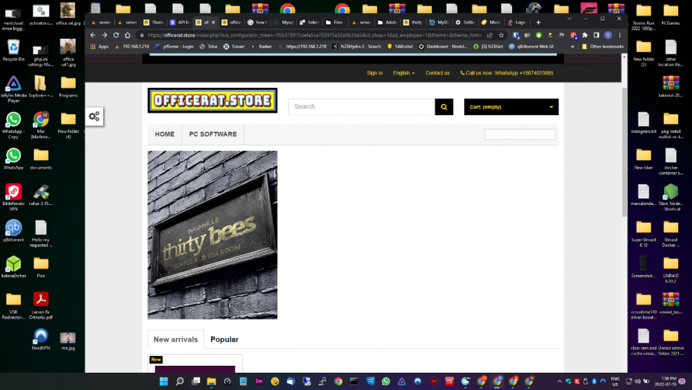

  16. Hi, can somone please tell me how to remove this thirtybees picture from my store home page? I looked through every module and I can't find this photo.
