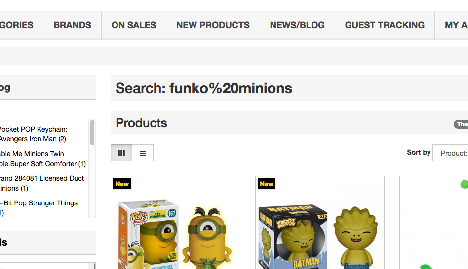

violinparts Posted August 21, 2018 Posted August 21, 2018 %20 shows in between when searching using two words See screenshot attached.
doclucas Posted August 21, 2018 Author Posted August 21, 2018 If you never use the "manufacturer" attribute, I assume you can use your "manufacturer" field as "brand" by putting the brand names you sell in there when you add or update products. That should work, at least as a sufficient workaround. As for the 20%, I don't have this issue on my installation and I don't see it on your website either: https://rackmetro.com/#q=pop%20movies
violinparts Posted August 21, 2018 Posted August 21, 2018 That's really strange. Have you tried to press enter next to the two words search? %20 shows in between - as you see in my attachment - on Firefox and Chrome. It does not show up on Safari. You will see it when you press Enter next to two words - on Chrome, Firefox, Android.
doclucas Posted August 21, 2018 Author Posted August 21, 2018 Oh I thought you mean it happens while typing. Yeah, I can reproduce your issue after submitting (pressing enter)
