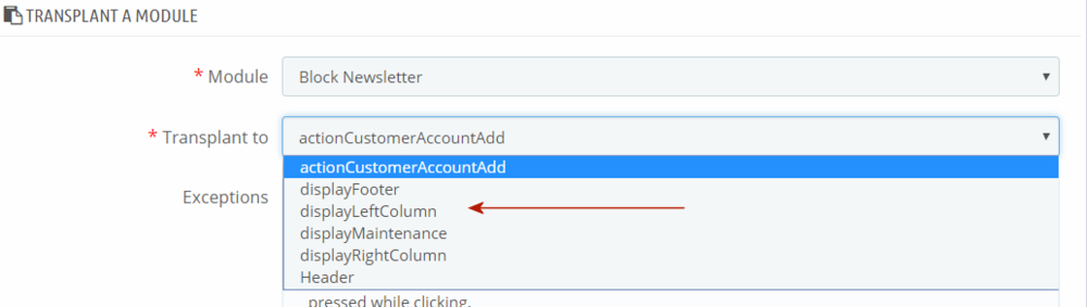

But....Here is an example of my confusion.
I go to Modules and services -> Positions, then I select "Transplant A Module"
This brought up
I choose "Block Newsletter" and then in the "Transplant to" section I only had a few choices.   "displayLeftColumn" was one of these choices, so I made the assumption that the Block Newsletter would work there.
So is it correct to say that even if a section appears in the "Transplant to" selector, the block may in fact not work there?
If this is the case, then how does one know?   Just try position and see what works?
