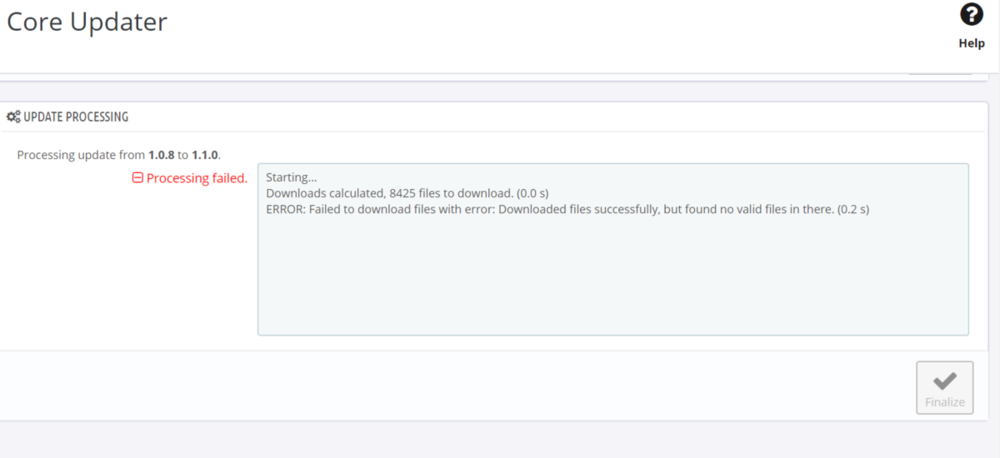

Javier Trujillo Jimenez Posted October 5, 2019 Posted October 5, 2019 Hello everyone, I have version 1.0.8 installed and I want to update to version 1.1.0, but when it is going to update I get the following error ...
Traumflug Posted October 7, 2019 Posted October 7, 2019 I just tried, the server appears to work fine. Could you simply try again? Maybe you've hit a weak spot. Updating multiple times, even after failures, should work fine and give the expected results. If it still doesn't work I'd need access to the server to find out why these packages arrive empty.
Traumflug Posted October 15, 2019 Posted October 15, 2019 Got it. This small change to Core Updater fixes it: https://github.com/thirtybees/coreupdater/commit/56ef3e2e1eb0e7ab9175477d9365ae33e6167a4e 1
