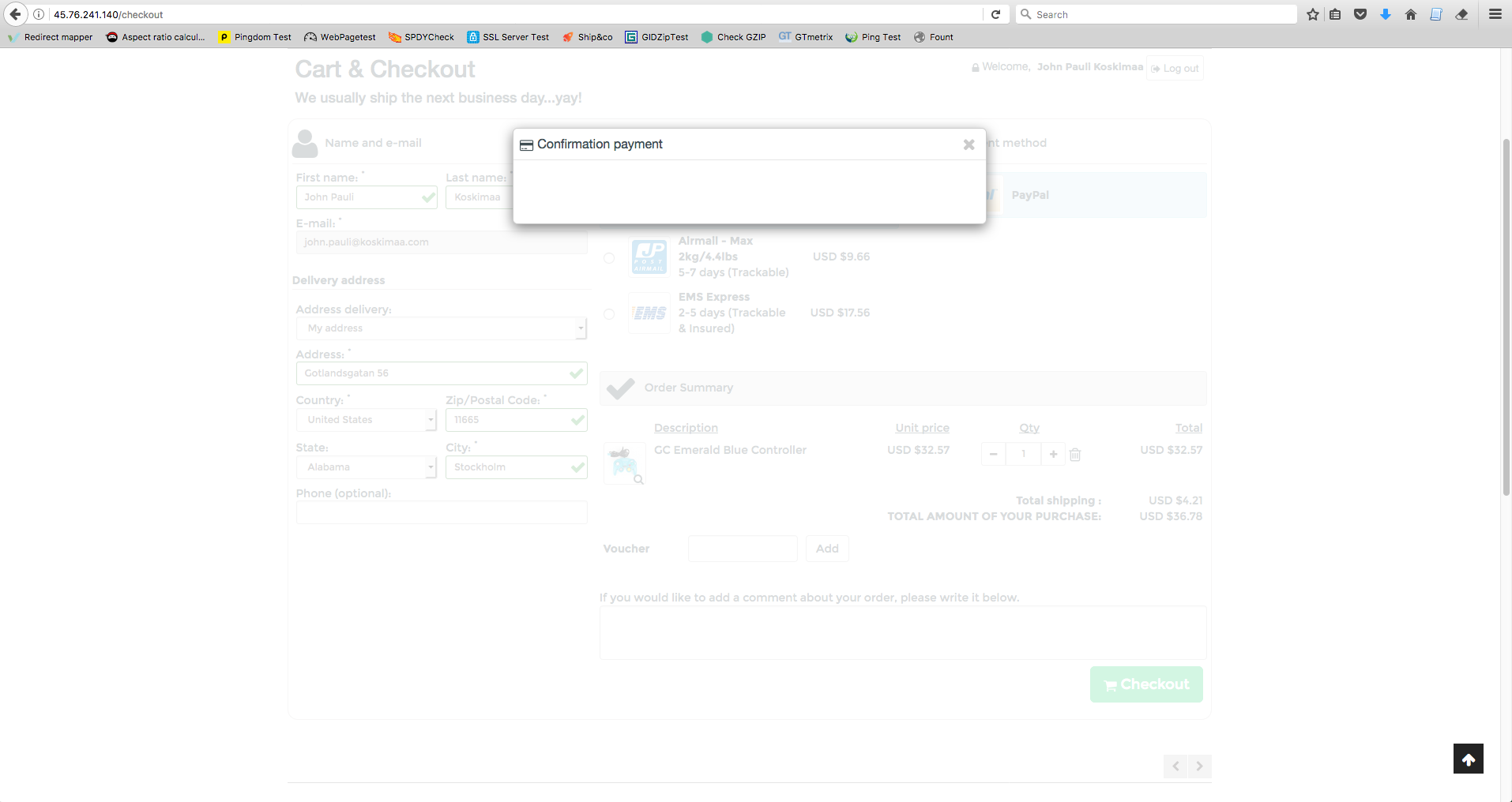

koskimaa Posted June 9, 2017 Posted June 9, 2017 Hey guys! Just migrated my PS 1.6 store to TB, looks good so far! I'm setting up the new PayPal module, but I'm not able to get anything to show up in the "Confirmation payment" window at checkout. What could the problem be? Also, is there a way to make it work like the old module where the customer gets redirected to PayPals site for login and payment?
Havouza Posted June 9, 2017 Posted June 9, 2017 But I thought they still get redirected. The difference is that the Paypal page opens in an iframe that looks like it is from the shop. Or am I wrong?
koskimaa Posted June 9, 2017 Author Posted June 9, 2017 @Havouza said in PayPal Confirmation Payment window shows nothing: But I thought they still get redirected. The difference is that the Paypal page opens in an iframe that looks like it is from the shop. Or am I wrong? Aha, well that could work too. Main problem right now is that nothing shows up in the window...
yaniv14 Posted June 9, 2017 Posted June 9, 2017 I think you can add in the one page checkout module you are using which module not to pop up in a window. you need to add the paypal to the list of modules.
koskimaa Posted June 10, 2017 Author Posted June 10, 2017 @yaniv14 That did the trick! It made it work like before. Now I have other problems but the problem of this topic is solved, thanks to you!
