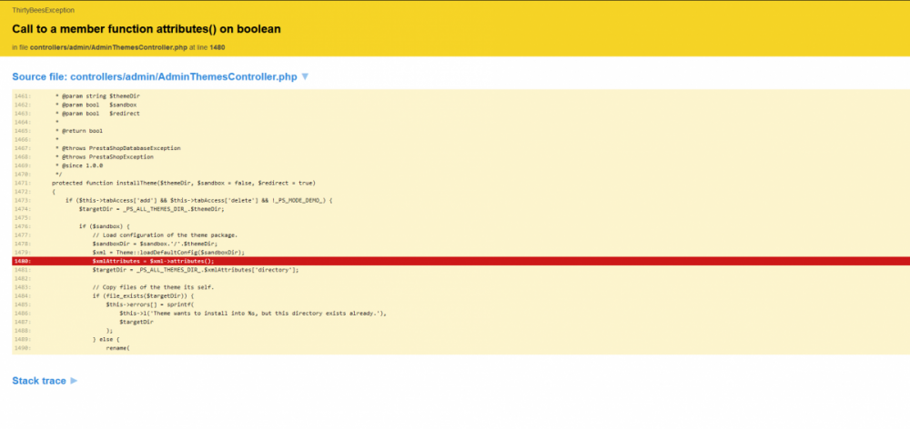

sardinas Posted May 13, 2020 Posted May 13, 2020 Can Someone help me with this? I am trying to upload themes that I have download from free prestashop themes. In this error comes out I've done it in 2 themes already
datakick Posted May 13, 2020 Posted May 13, 2020 First of all, you should update your thirtybees to bleeding edge using core updater. It will give you better error message, at least. Anyway, to your question -- thirtybees failed to load config.xml file from the zip file. The file either doesn't exists, or it is not a valid xml file. You should examine zip file to see it's content. Sometimes, zip file distributed by theme developers contains another zip file (the actual theme archive) and few other files, like installation manual or documentation.

sardinas Posted May 13, 2020 Author Posted May 13, 2020 Is from config file folder? because I don't see any config.xml. Also I've update thirtybees to bleeding edge. And upload the theme again and these error comes out. " Bad or missing configuration file. "
datakick Posted May 13, 2020 Posted May 13, 2020 1 minute ago, sardinas said: Is from config file folder? because I don't see any config.xml. This one
datakick Posted May 13, 2020 Posted May 13, 2020 This doesn't look like ps16 theme, it's probably ps17 theme. Correct? If so, then you can't use it on thirtybees. Prestashop 17 modules / themes are not compatible
