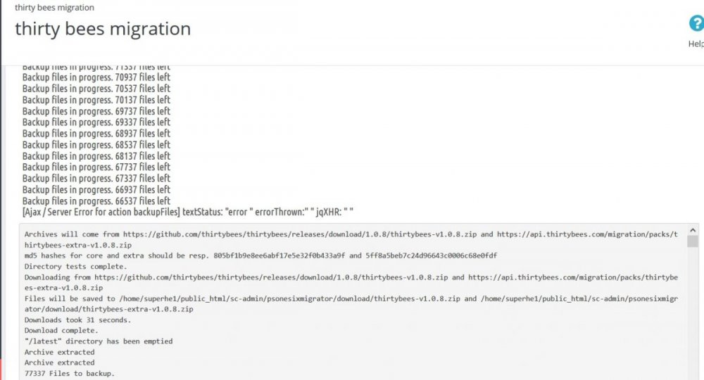

I've tried migrating from Prestashop 1.6.1.4 but when it's finished, it's appeared this log. I tried refresh the browser but seems nothing changed. Still my current Prestashop. Is there anything I should disable first before attempt another migration?

I'd backup by other means and try again without making a backup. There's a switch for that under the button for proceeding. Removes the need to solve the problem 🙂
Solving the problem would require to catch this failed response in the browser's developer tools and if this still gives no good hints, to insert debugging code into the migration module until the problem is found. Obviously a time consuming process.
BTW., one can scroll the log in this grey-ish box, latest messages are at the bottom.

Yes, finally managed tp migrated. I've disabled the backup and do it manually. Tahnk you for your replies. Appreciated it.
