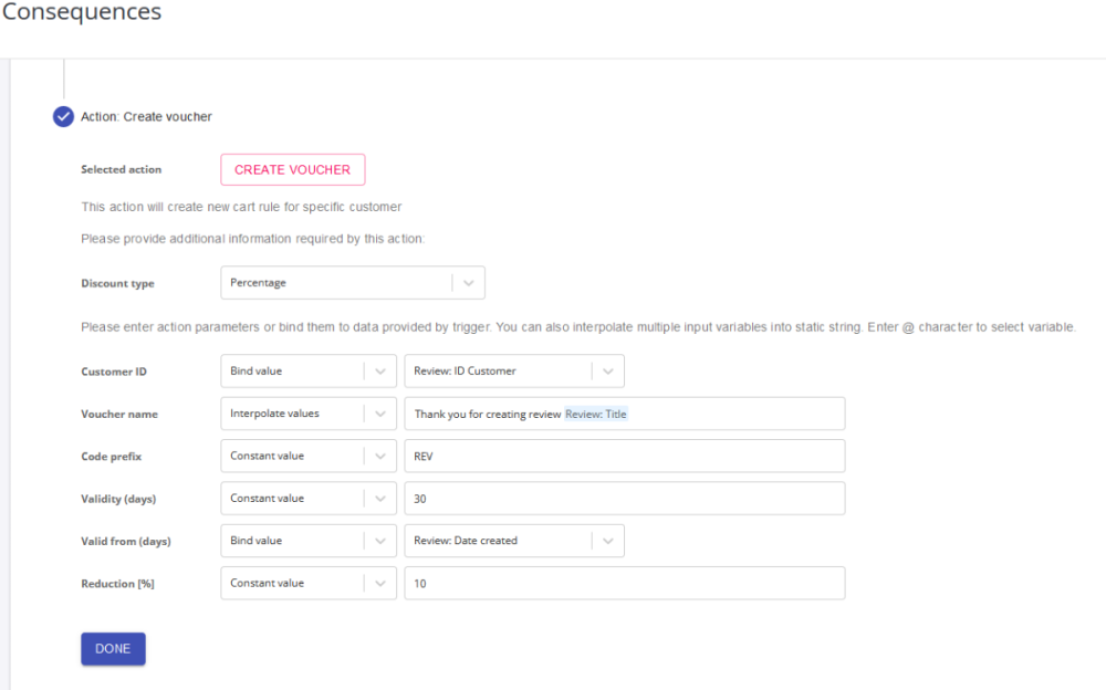

Kevin13952 Posted June 19, 2024 Posted June 19, 2024 @datakick I'm trying the free version of Conseqs module. I'm very interested in it for multiple things in my shop. However, I've imported the Package to send voucher after an approved review, and it's not sending the voucher by either email or by adding it to the customers account. I'm sure I'm doing something wrong. I've attached a screenshot of the settings if you could give me some guidance. Thank you!
datakick Posted June 20, 2024 Posted June 20, 2024 On 6/19/2024 at 3:18 PM, Kevin13952 said: @datakick I'm trying the free version of Conseqs module. I'm very interested in it for multiple things in my shop. However, I've imported the Package to send voucher after an approved review, and it's not sending the voucher by either email or by adding it to the customers account. I'm sure I'm doing something wrong. I've attached a screenshot of the settings if you could give me some guidance. Thank you! Expand Hi, I've just tested this and it works as expected. The cart rule was created for specific customer: There is no email sent by default when cart rule is created. But you can do that by adding another rule 'After conseqs rule'
