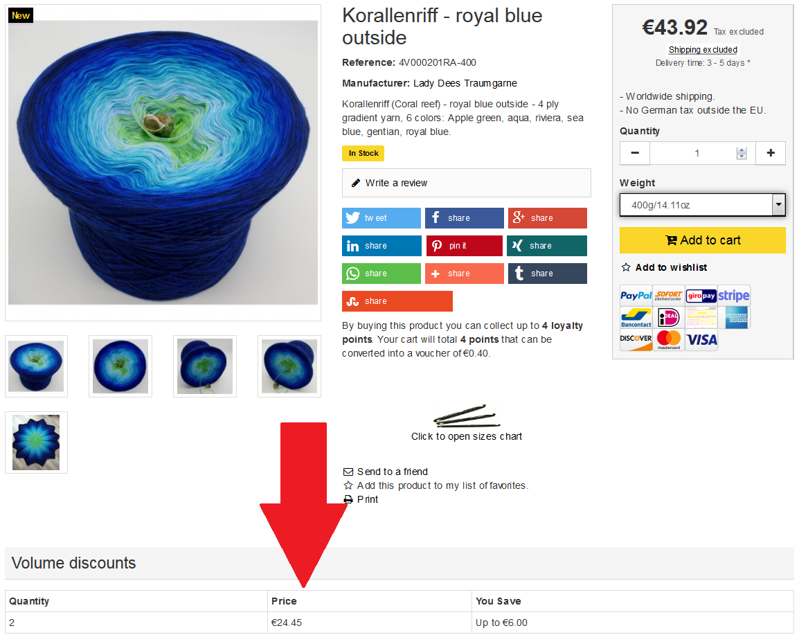

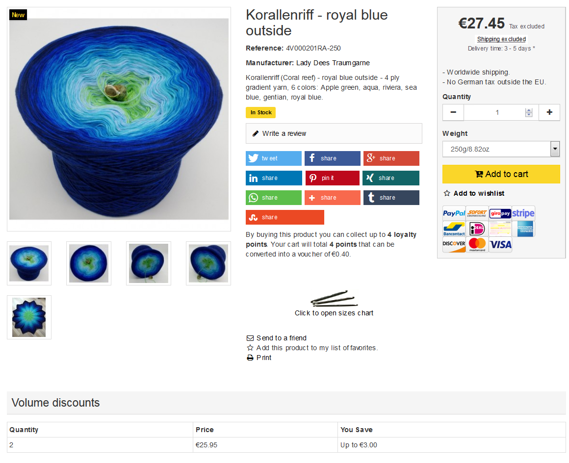

i see now, that i have problem with the right prices with volume discounts and product combinations. i think its a problem with AEUC module.
you can see it on image 2 43,92 € - 3 =24,45 € ????
page https://ladydee-yarn.com/en/4-ply-yarn/korallenriff-royal-blue-outside
0_1502269420283_FireShot Screen Capture #241 - 'Korallenriff - royal blue outside - Lady Dee´s Gradient Yarn' - ladydee-yarn_com_en_4-ply-yarn_korallenriff-royal-blue.png0_1502269436848_FireShot Screen Capture #242 - 'Korallenriff - royal blue outside - Lady Dee´s Gradient Yarn' - ladydee-yarn_com_en_4-ply-yarn_korallenriff-royal-blue.png
