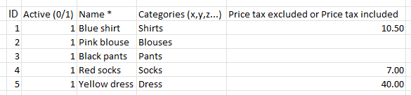

Firstly when i import a products i get theese type notices in the error log:
Secondly, when importing combinations, i get this notice:
And lastly, when I import, only webp images are generated. Consistency check tells me that images registered in the database does not exists and that i should delete them, only .jpg images. When follow the recommendation and delete them in the consistency check interface, the product in the front office no longer shows any images:
