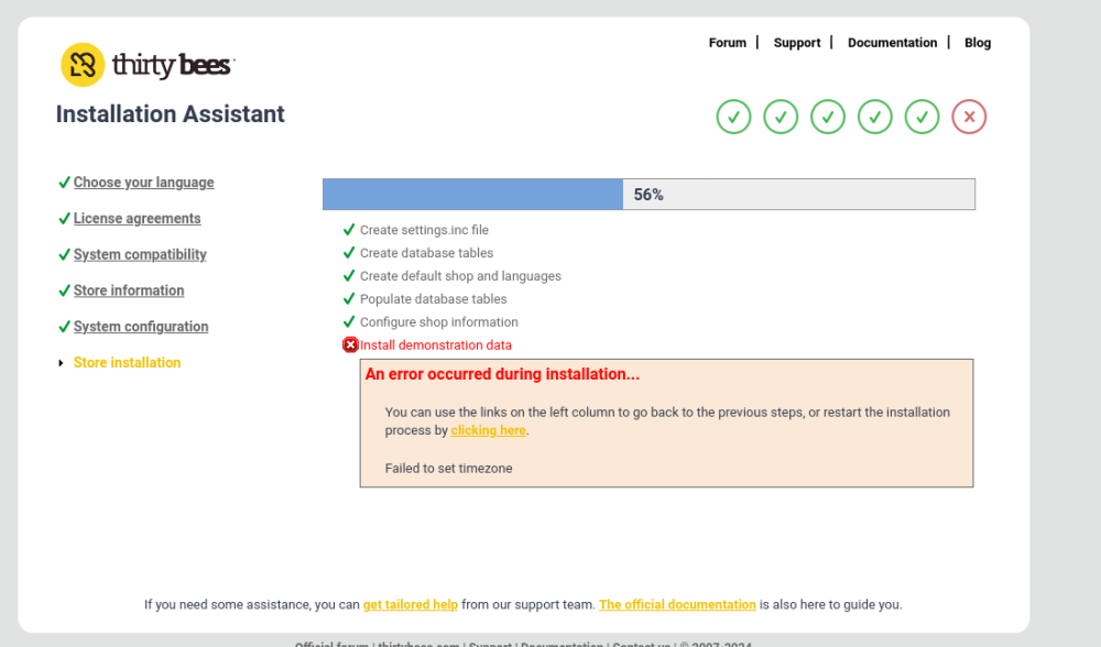

taj Posted Saturday at 04:41 PM Share Posted Saturday at 04:41 PM (edited) When I run the installation, I get to "install modules" and get the following error: An error occurred during installation... You can use the links on the left column to go back to the previous steps, or restart the installation process by clicking here. Failed to set timezone The timezone I choose in installation is the same as the server. What am I missing? Edited Saturday at 04:42 PM by taj Link to comment Share on other sites More sharing options...
0 DRMasterChief Posted Sunday at 09:37 AM Share Posted Sunday at 09:37 AM Hi, try another timezone and/or country! You can change this later in Backoffice to the correct settings. Link to comment Share on other sites More sharing options...
