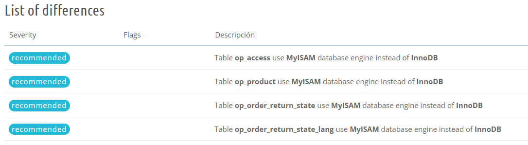

Carlos Minguell Posted Wednesday at 03:21 PM Author Posted Wednesday at 03:21 PM Many thanks for your reply, There are no problems creating customer accounts with accent in first letter of name, the error is showed when the customer clics on the "pay with credit card" button in the fifth steep. When the word with the accent is in the surname or other field, the problem doesn't appear. I have Applied fix in Database Schema to some lines that showed "..._unicode_ci" instead of "..._general_ci", but the error appears again. In Core Updater there are also a lot of lines with the error you can see inthe attached image. Should I fix it or is it not important? Many thanks and best regards,

datakick Posted Wednesday at 04:21 PM Posted Wednesday at 04:21 PM Check if you can complete order using other payment method. If you can, then it's a bug in this third party module. Ask developer to fix it, or hire someone
