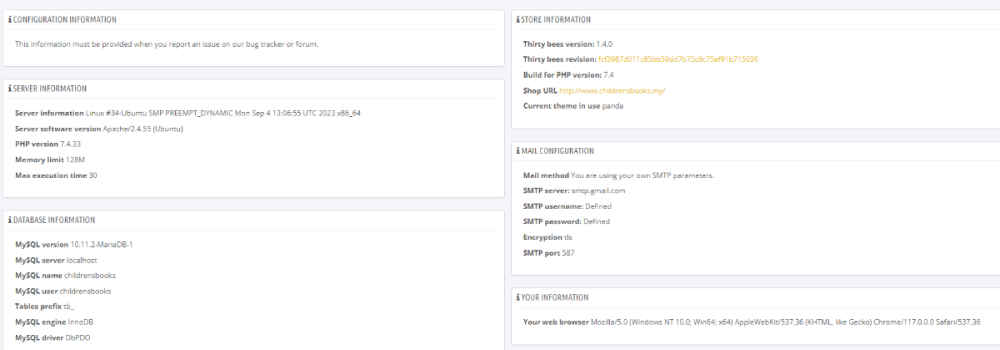

Hi, Sorry to revive an old thread but I still haven't managed to solve this issue. I just have the honour the sale and pay for the shipping when it happens. However, this means I can't ship overseas as the losses could be significant. I was wondering if there is anything in the configuration or it is something to do with the caching. Any ideas would be appreciated. Regards, Luke SERVER INFORMATION Server information Linux #1 SMP Tue Aug 25 17:23:54 UTC 2020 x86_64 Server software version Apache PHP version 7.0.33 Memory limit 256M Max execution time 30 DATABASE INFORMATION MySQL version 5.5.65-MariaDB MySQL server localhost MySQL engine InnoDB MySQL driver DbPDO STORE INFORMATION thirty bees version 1.0.7 Current theme in use panda CHECK YOUR CONFIGURATION Required parameters OK Optional parameters Please fix the following error(s) Test result: fail LIST OF CHANGED FILES Changed/missing files have been detected. Updated files (3) /srv/www/XXX/html/classes/Meta.php /srv/www/XXX/html/classes/Validate.php /srv/www/XXX/html/controllers/front/ProductController.php -
