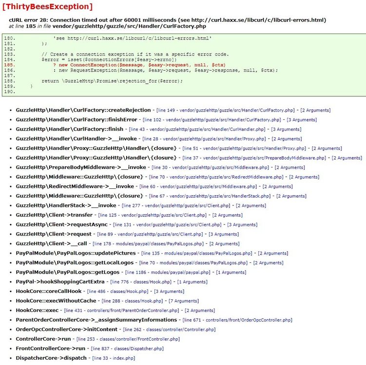

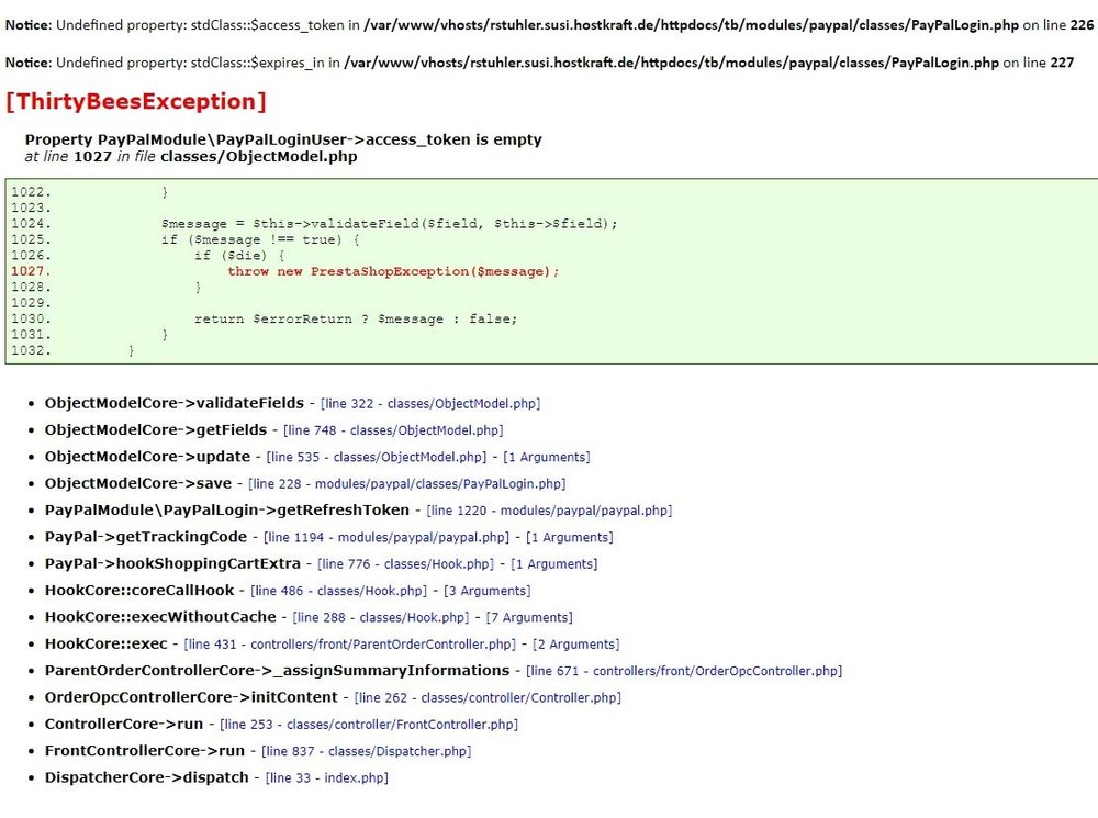

By commenting out line 292 of the paypal.php file, I handelt to uninstall the TB PayPal module. But after reinstalling it, I have exactly the same problem / the same error page when trying to make a payment. Don't know if this information is helpfull for you. -

@wakabayashi thank you for mentioning 🙂 @datakick thank you for the tip. It worked perfectly for me. PayPal module is uninstalled now 👍 -

I put the code in line 224 like you said: Now it takes about one minute to load the error page and it looks like this: -

Hello musicmaster, thank you for the suggestion. I've reset the PayPal Plus module and even reinstalled it. No changes. When I try to reset the TB PayPal module I get this error page: Very strange! Best regards, Robin -
