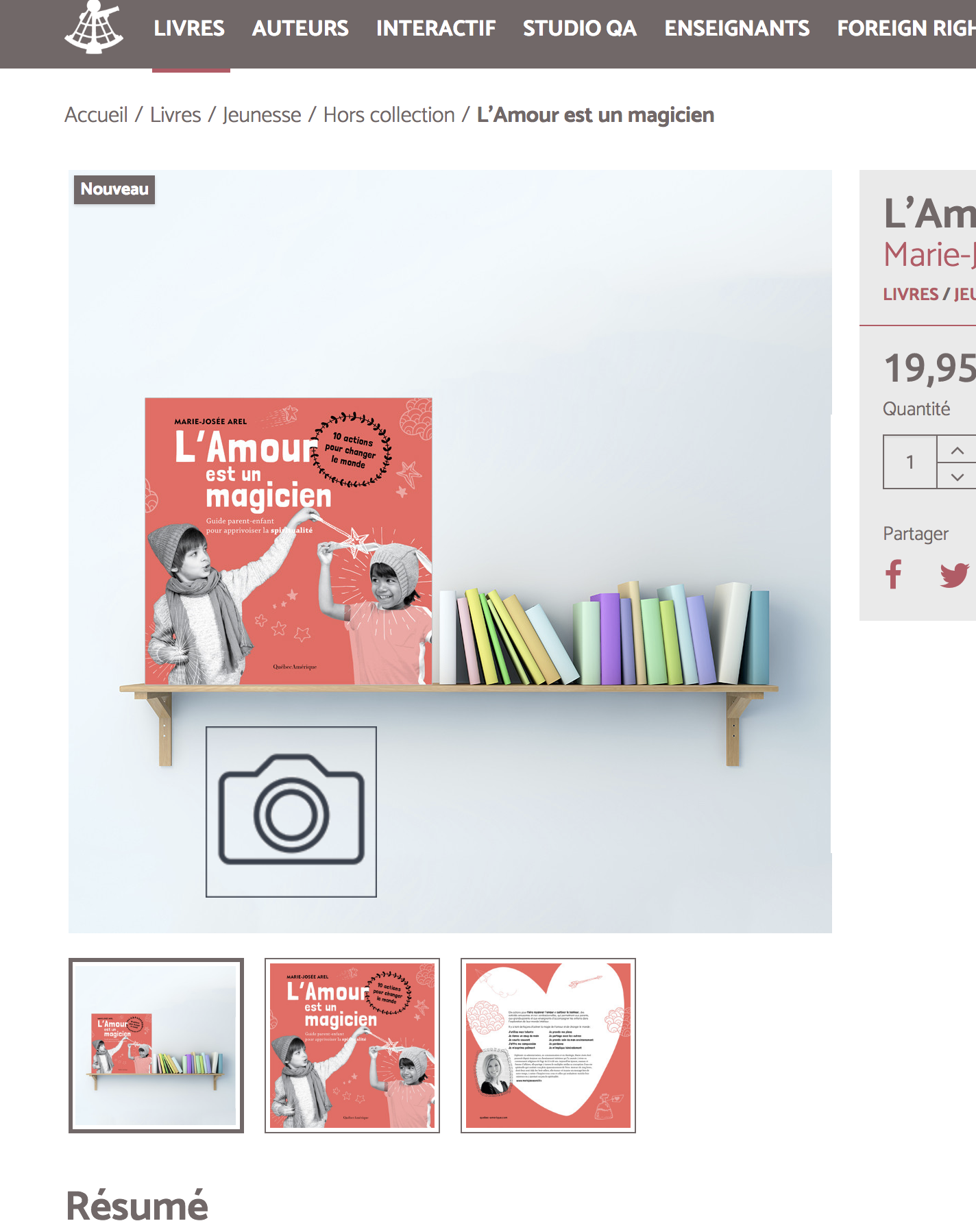

ssimard Posted January 18, 2018 Posted January 18, 2018 Hi everyone, I have just put my website online and I was asked why I was not using JqZoom instead of fancybox. I forgot why at first but now I remember why, can anyone help me fix that ? When I load a page at first, it looks like it was not initialized properly. It's working only after I rollover on a thumbnail. Here's a screenshot of what I get if I don't rollover a thumbnail first (the camera image is following the cursor):
0 yaniv14 Posted January 18, 2018 Posted January 18, 2018 Its look like your are missing an image. But the zoom should work only when hovering the image
0 ssimard Posted January 18, 2018 Author Posted January 18, 2018 After loading a page, if I hover on the image, I get that camera image following my cursor and no zoom is happening. As soon as I hover or click a thumbnail then go back to hovering the main image, the zoom works.
0 yaniv14 Posted January 18, 2018 Posted January 18, 2018 Can you turn it back on so I can check? Because I've checked it on my TB dev installation and its working fine
0 ssimard Posted January 18, 2018 Author Posted January 18, 2018 I did, turned it on for you. Let me know once you've seen it so I can turn it back off please. Make sure you do not rollover a thumbnail on page load.
0 yaniv14 Posted January 18, 2018 Posted January 18, 2018 Try modifying you zoom init function to match the name of your large image. look inside themes/yourtheme/js/product.js for initZoom( $('#bigpic').attr('src').replace('large', 'thickbox') ); to initZoom( $('#bigpic').attr('src').replace('produit_large', 'thickbox') );
0 ssimard Posted January 18, 2018 Author Posted January 18, 2018 Awesome, I did just that and it fixed it, many thanks !!

ssimard
