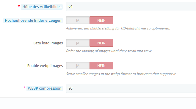

I deactivated the functions - Lazy load images - Enable webp images and afterwards the import worked without problems
I had both turned off without further testing. whether it is only one of the two, I can not say therefore.

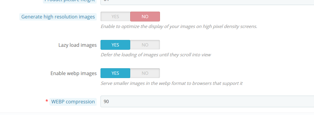

@colorful-ant I went in and disabled each of those as well as "generate high resolution images" and then activated them one by one. It appears that it is the high resolution image generation that is the problem. The upload does not fail with the below configuration.
ok, right now it's done for me. I also did not receive an exact error message when importing. Also not with debugmod-on. The import with my picture above in the settings had worked. Maybe others can say something else. I have no time to test right now.

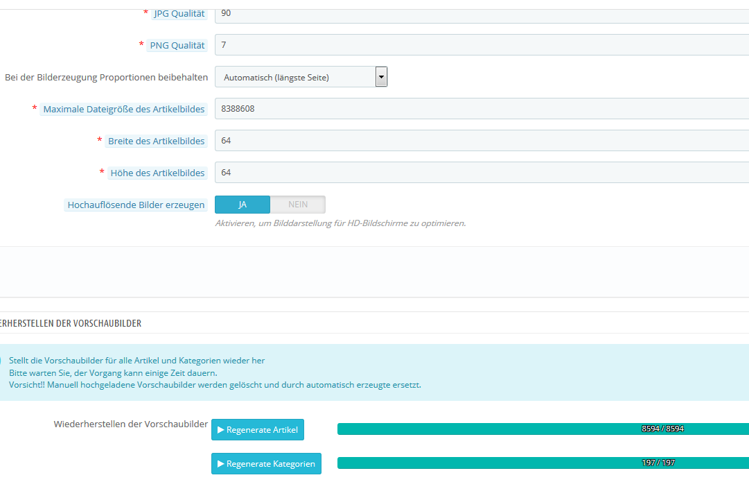

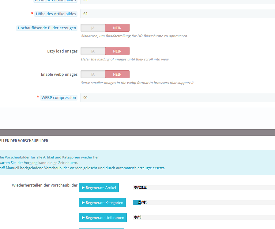

the curious thing is that I am just further confused. with a fresh installation of 1.0.4. I see the options.
In another shop from 1.0.3 (without migration of PS) with update to 1.0.4, I do not see these options. All caches emptied, including class_index.php removed.
new 1.0.4 installation
-- new 1.0.3 with update to 1.0.4 0_1527546275275_2d7eef1a-4592-49f6-b9aa-316300098661-image.png
