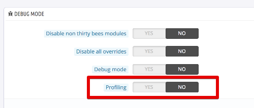

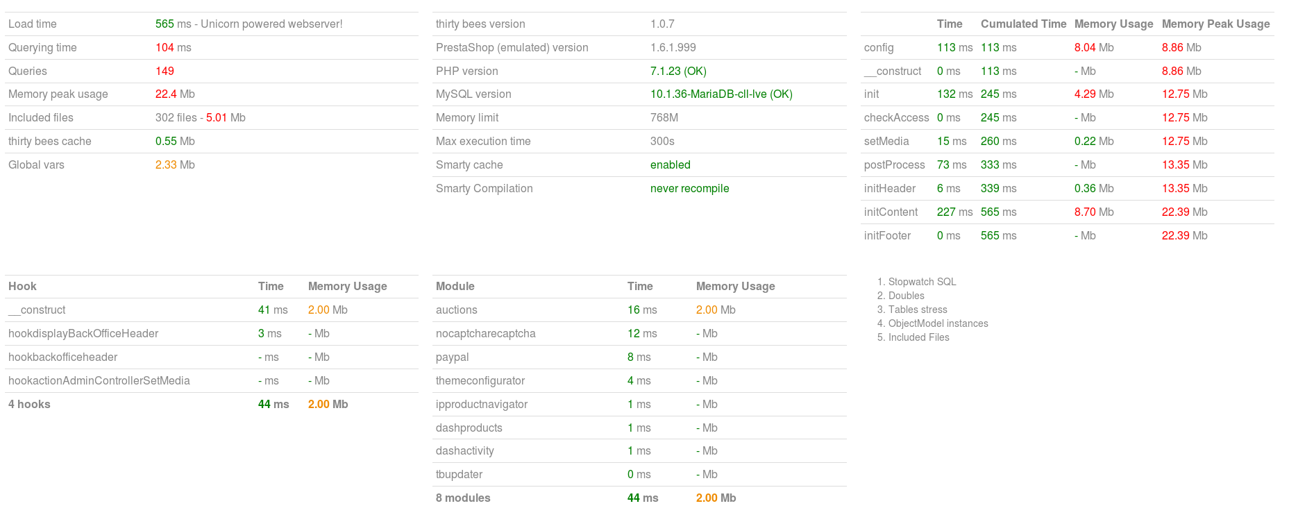

datakick Posted October 25, 2018 Posted October 25, 2018 This warning has nothing to do with the slowness. You have probably enabled debug mode, not profiling. Enable profiling, and then look at the bottom of the page for performance statistics That should give you the basic idea what's slow in your system
cprats Posted October 25, 2018 Author Posted October 25, 2018 @datakick Sorry, it was debug, you're right. This is the profiling result:

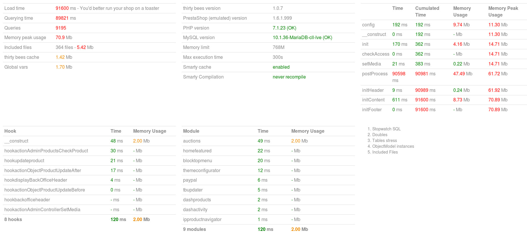

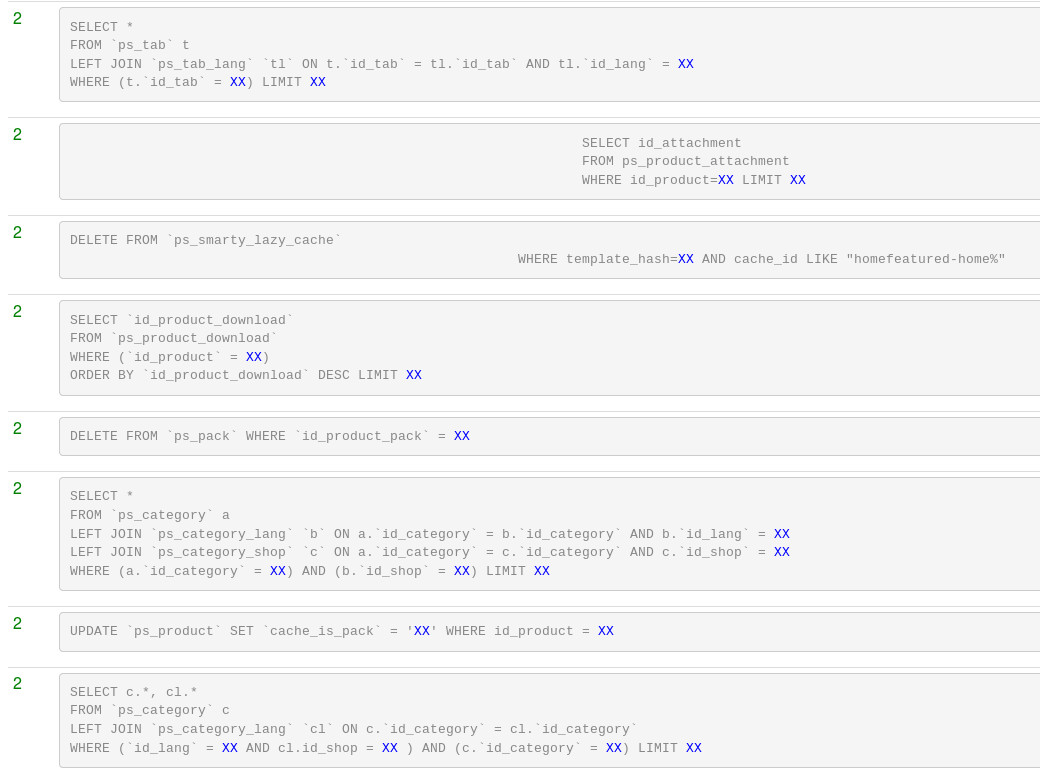

cprats Posted October 26, 2018 Author Posted October 26, 2018 @datakick I tried again and now I've got one of the slow products. It only happens if I change all categories. For example, a product in Categories-New-Covers will not experience a slow modification if changed to Categories-New. But, If I unselect all categories and I select a different category (for example, Sold Idems) saving process will be extremely slow. Here a screenshot of profiling while editing one of these products:

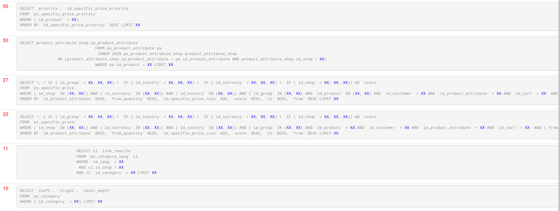

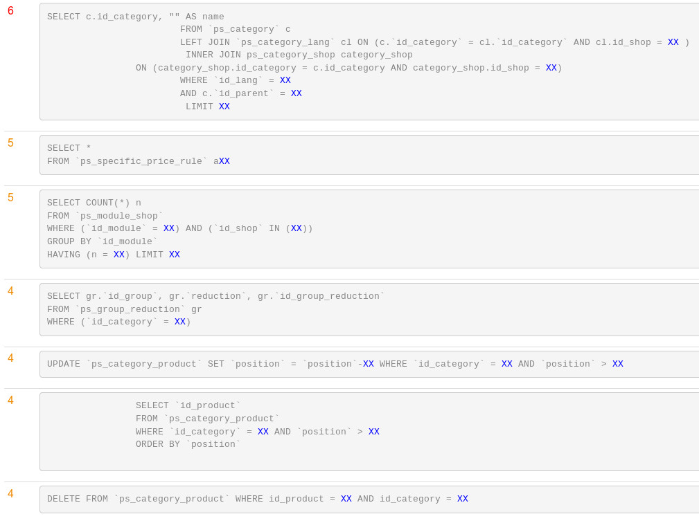

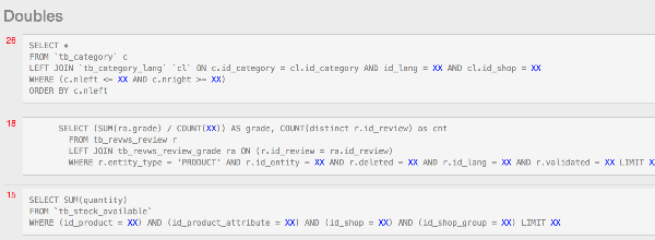

datakick Posted October 26, 2018 Posted October 26, 2018 @cprats we are getting closer. There are over 9000 sql queries -- that's way too many. Normally you shouldn't see more than 300. I bet there's some very inefficient loop that's executing some query over and over. Please look at the bottom part of the profile stats, and search for section with sql statements named Doubles. It looks something like this (the red number says how many time was this sql executed)

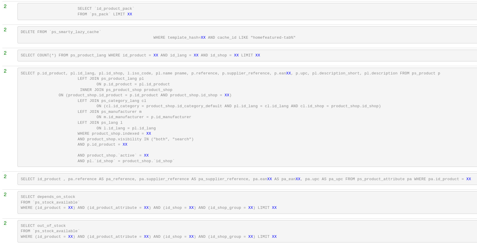

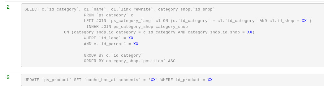

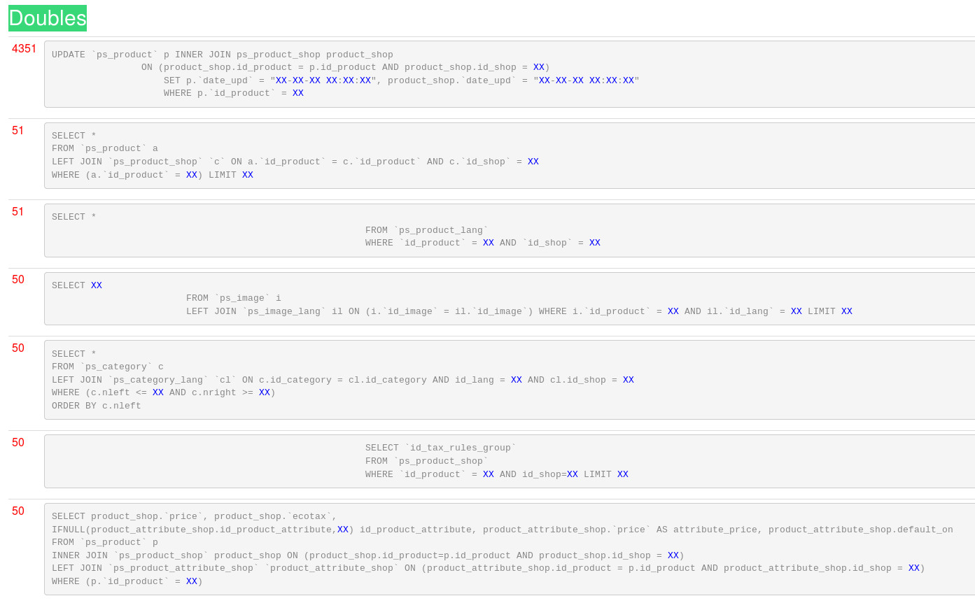

cprats Posted October 26, 2018 Author Posted October 26, 2018 @datakick Here is the Doubles section in 6 screenshots:
cprats Posted October 26, 2018 Author Posted October 26, 2018 It seems the problem is with idproduct. I am using this route to products in schemaurls: {categories:/}{rewrite} instead of the configuration I had when the core was Prestashop: {category:/}{id}-{rewrite}{-:ean13}.html
datakick Posted October 26, 2018 Posted October 26, 2018 There is indeed very inefficient piece of code in classes/Product.php, function cleanPositions. When you remove product from a category, all products that are associated with that category and have higher position gets updated. In your case this leads to thousands of sql updates. They are very fast, but it adds up. That's also the reason why you experience this problem only with olded products -- they have lower positions inside categories. New products have higher position, so the total number of updates is much lower. I'll prepare a fix and push it to thirtybees 1.0.8. Meanwhile, this is what you can do to avoid this problem: edit file classes/Product.php, find function cleanPositions, and remove these lines.
