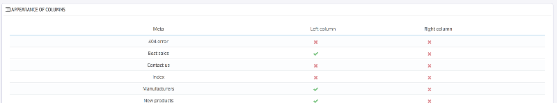

In my theme, the "edit" theme button is missing. It used to be there. See this: www.bryankollar.com/left001.JPG

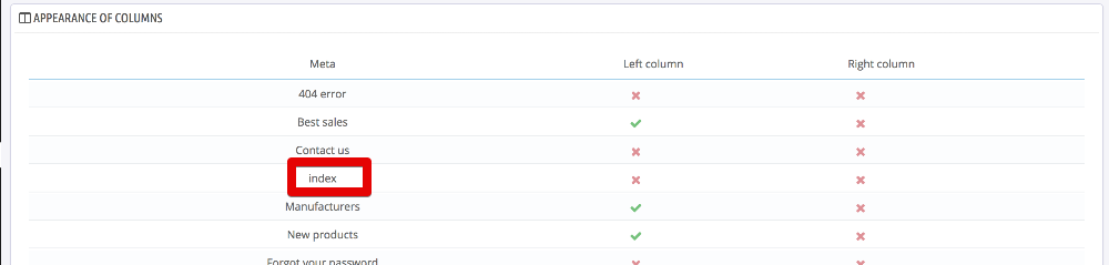

Where the horrible circle is, is where it used to say edit. So anyway, when I go into advanced settings, you'll see I do have left & right enabled www.bryankollar.com/left002.JPG

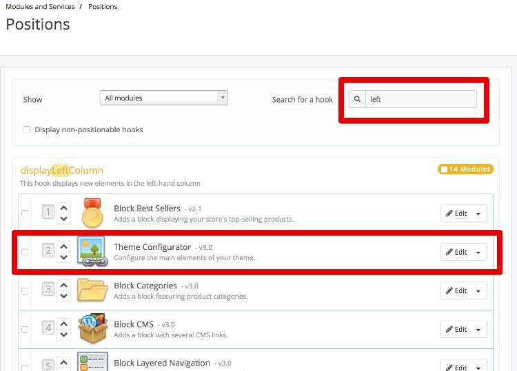

And finally, I have my item hooked to the left, here: www.bryankollar.com/left003.JPG
So... Why doesn't anything show?

re #2) turn on your left/right column on individual pages as well, then your content should display on those pages 0_1540967921255_bbd1cbcc-87f5-4c74-a6a2-22f1d89cc784-image.png
Hi, Datakick! OK, I will alter that file so I can get my edit button back. Thanks! But as far as #2 goes, yes, I did forget to mention that I have selected the left and right as indicated above in your snapshot. Any idea why they are still not showing?
THANK YOU! THANK YOU! THANK YOU! THANK YOU! THANK YOU! THANK YOU! THANK YOU! THANK YOU! THANK YOU! THANK YOU! THANK YOU! THANK YOU! THANK YOU! THANK YOU! THANK YOU!
I've tested it and it works on my 1.0.7 as expected. Verify that you have themeconfigurator module enabled. You can also check that this module is in list of hooks called for left/right columns:
@datakick Well, thank you very much. That helped - I'm a lot closer. Your direction led me to seeing the "reset" button. I never remember seeing it before. So - I clicked that. NOW, I can see the left hand side block, BUT it's only after I view a product or navigate through the website. If I can get the left hand block to show on the main page, I'll be all good to go. Can you tell me how to do this now that I can see it on the pages within the site (before I couldn't)
THANKS
AND.... That solved it! DataKick, thank you for being the only one to answer. It now works. :) My block is towards the bottom though, so I will search and see how to move it to the top. You're the best!
