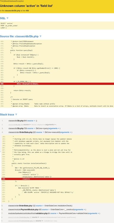

unknown column active in field list - ps_order_state
When I make a bankwire payment in the new 1.1 version the next screen is an error screen that there is a query for a column "active" in the table ps_order_state. Indeed when I checked this column doesn't exist in this table.
When I look at the code it seems that this is some kind of coreupdater check that is done for many tables and goes wrong here.
I "solved" the problem by manually adding an active field to this table.
When I checked on my server - where I had started with a direct payment instead of bankwire - I noticed that the system had added there an active field by itself.

There are two database structure changes between 1.0.8 and 1.1.0 - tables tb_order_state and tb_order_return_state received new column named active. Because the metadata-based comparison is not released yet, and because there is no support for legacy sql migration script, there had to be implemented nasty workaround to create these new columns. Basically, whenever the OrderState object is created, thirty bees checks that the active column exists. And if not, it creates it.
This adds some performance drag. And, unfortunately, it also contains a bug. The check uses following sql query:
SELECT `active` FROM `tb_order_state` LIMIT 1
But, obviously, this sql query fails terribly when active column haven't been created yet. In normal mode, thirtybees swallows database errors, so this check somewhat *works*. But if you have debug mode enabled, this invalid sql query is converted into php exception like the one @musicmaster reported.
The workaround around this issue is simple:
  1. go to Advanced Parameters > Performance
  2. disable Debug mode
  3. go to Orders > Statuses
And that's all. Both columns should be created now, and you can re-enable debug mode
