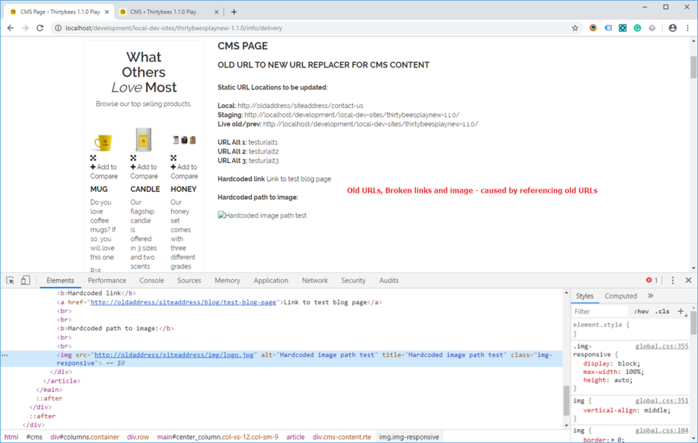

CMS Edit: Broken links, old URL references, broken image
CMS Front-end page: Broken links, old URL references, broken image

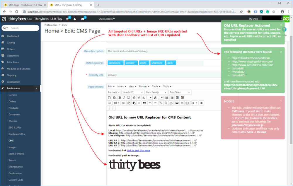

CMS With Old URL to New URL Replacer Script Active and working - images and broken links fixed - with Bonus 'native' growl notifications 😉

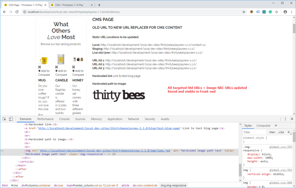

CMS Front-end page: Broken links and images now fixed
