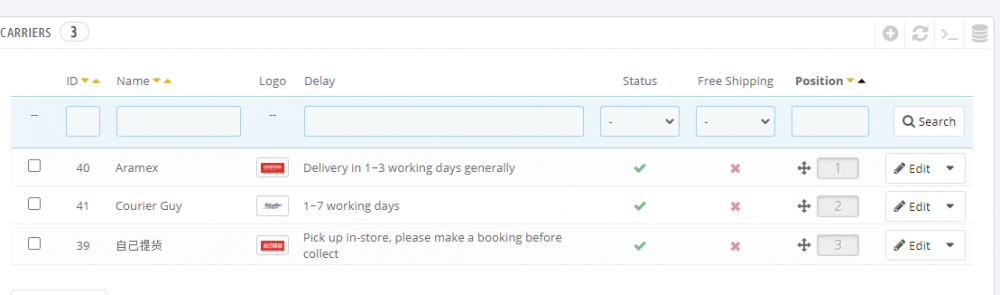

Yes, I have see regional setting, some products check out client could choose shipping method, but some not. Please see attached shipping method setting.

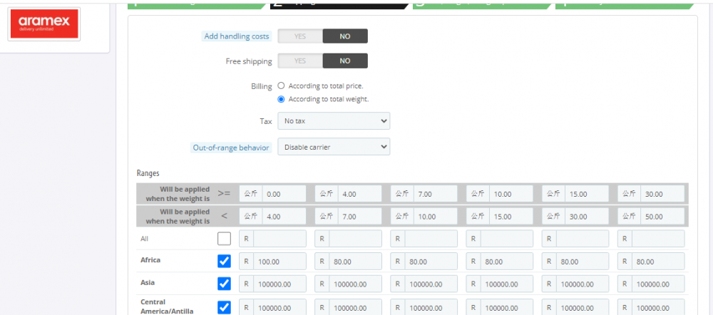

I've noticed you have different weight ranges, maybe your product weigt is out of those ranges. You can also try different price ranges and change your billing method to see if this will work.

Please show all your shipment settings to review.

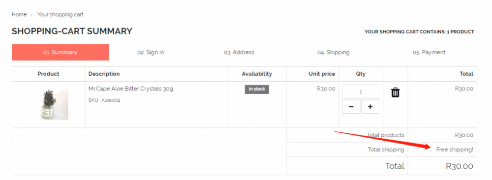

Thank you Piet, now it works better than before after setting their weight into very tiny number like 0.01kg, but the courier options seems unable to display, I have set already.
