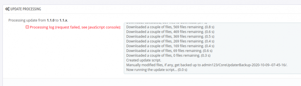

Hi folks. I've tried to update from 1.1.0 to Bleeding Edge to see if it fixes an issue in my last question (discounts not stacking correctly). When I run the update to 1.1.x I get this message:
773873681_Screenshotfrom2020-10-0908-45-25.thumb.png.fc758a693cd7b11bea957860b653feed.png
So there's no visible error in the console window, but the "request failed" seems to suggest it hasn't worked? And the Finalize button can't be clicked. The version in the top left corner reads as follows until I reverse update back to 1.1.0:
Is the update actually failing? And if so, is there somewhere I can get more information on why?

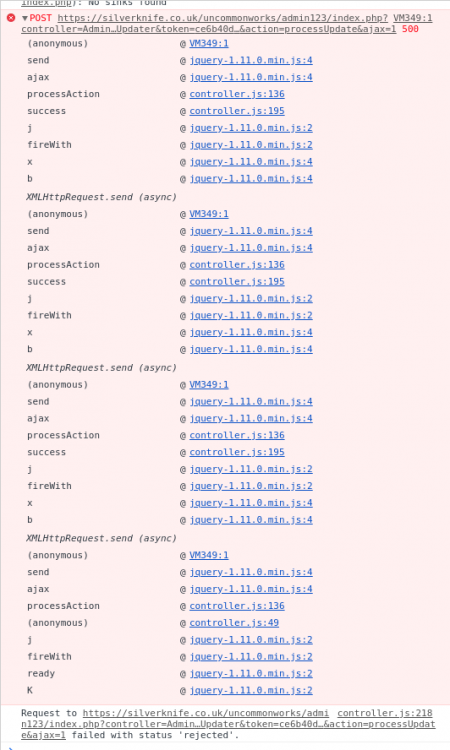

Did you look into javascript console? Are there any errors?
Oh, sorry, I'm an idiot (was thinking it meant the log on the right)...javascript console error here.

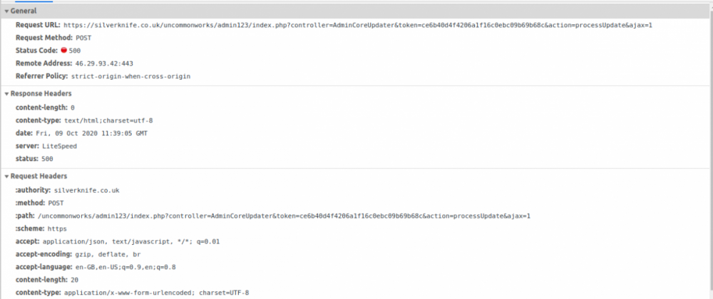

47 minutes ago, datakick said:
Please click to network tab, look up this failed request, and look into the response. There might be some helpful text.
Also, enable debug mode

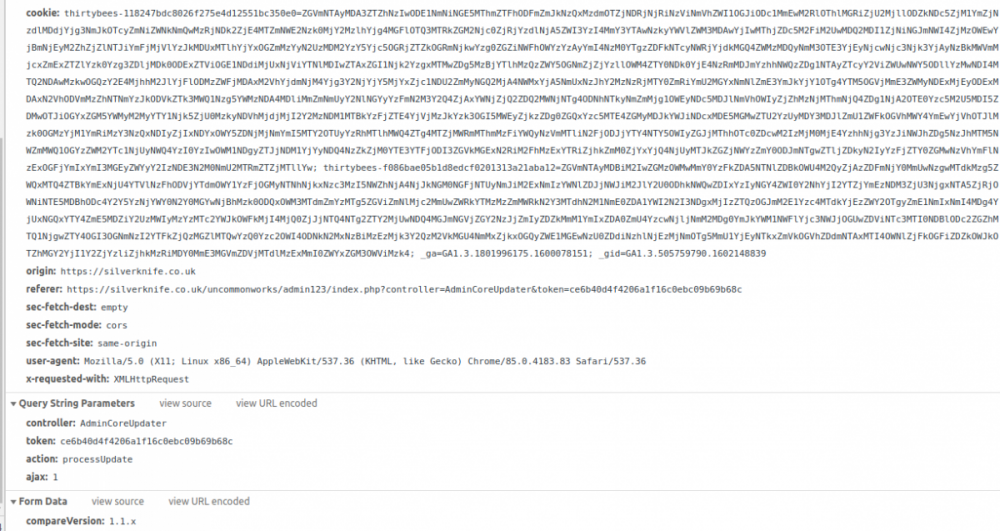

Okay, network request details here. I turned on debug mode but it didn't seem to add anything extra to the logs and turned itself off when I ran the update...

18 minutes ago, datakick said:
Almost there 🙂
What I'm interested in is not response headers and cookies, but response content. Look into Preview or Response tab:

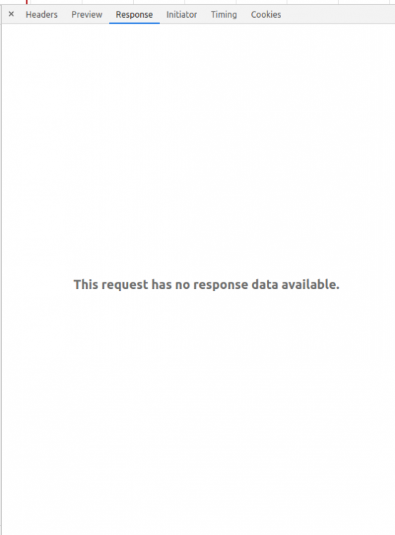

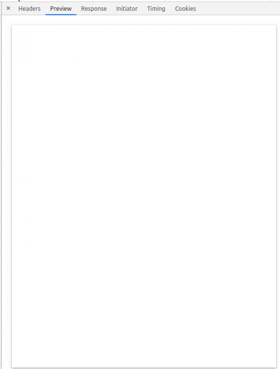

😁 Thank you for being patient with me! Unfortunately there doesn't seem to be any Preview or Response for that red request...
