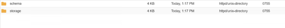

*ERROR*     2023/04/20 - 13:17:12: Fatal Error: require_once(): Failed opening required '.../modules/coreupdater/classes/Settings.php'
If I open the folder under /modules/coreupdater/classes/, there is no Settings.php file, only these 2 folders.
Why is this?
Can you try to delete the whole coreupdater folder? Please, back it up firstly!
Then try to access your BO->Modules
Probably coreupdater was part of the update and you faced some issue and the update did not complete fully.
If you have access to Modules, install coreupdater and proceed with the needed updates (system and modules) if aplicable.
This folder contents are as follows:
Edited by the.rampage.rado
Doing it now, seems to be working...
I believe that coreupdater was part of the modules that needed to be updated...
Done...
Thank you, this fixed the problem, all good now.
