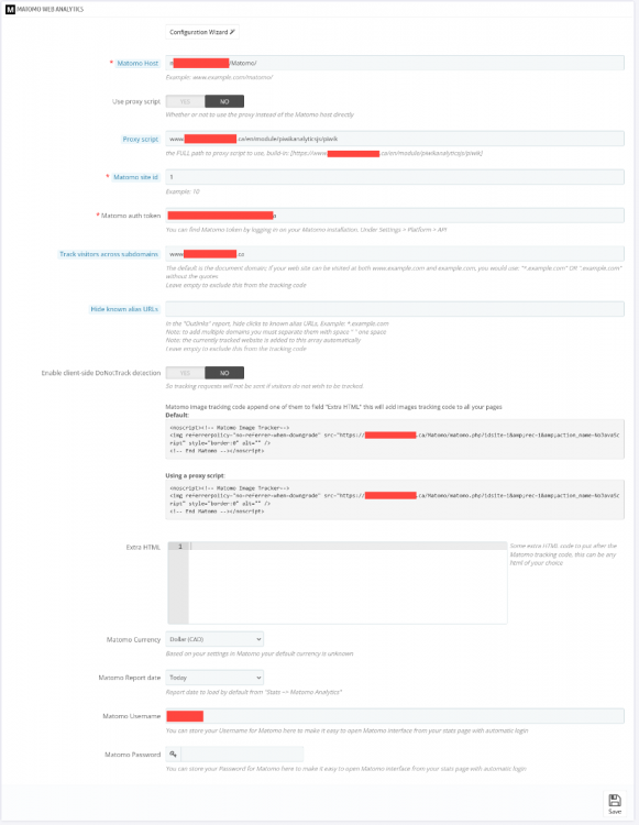

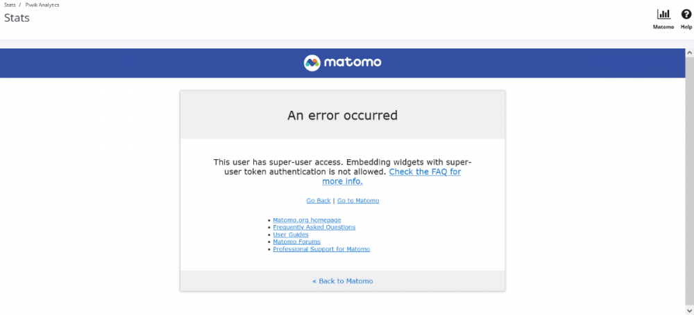

papagino Posted June 15, 2023 Share Posted June 15, 2023 (edited) Hello people, I recently installed Matomo Web Analytics v1.3.0 - by thirty bees on my Thirtybees 1.5 (offline and in progess) using PHP8.1. Matomo is working fine on their website, tracking and all.. However, whenever I click on the Piwik Analytic button in Stats of the backoffice I get this window: I have attached screenshot of my entire Matomo configuration page (blocked out sections for security reason) Can anyone help me identify what's wrong with my configuration? Any help would be very much appreciated. Cheers Dan Edited June 15, 2023 by papagino Link to comment Share on other sites More sharing options...
0 datakick Posted June 16, 2023 Share Posted June 16, 2023 Create read-only user in your Matomo, and then use this account to generate auth token Link to comment Share on other sites More sharing options...
0 papagino Posted June 16, 2023 Author Share Posted June 16, 2023 (edited) 7 hours ago, datakick said: Create read-only user in your Matomo, and then use this account to generate auth token Thanks, I had created a user with view only, but it looks like I used the wrong token in the configuration... Anyway, all is good now. Cheers Dan Edited June 16, 2023 by papagino Link to comment Share on other sites More sharing options...
