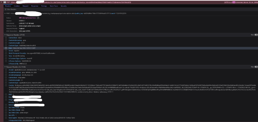

x97wehner Posted September 4, 2024 Posted September 4, 2024 We use pop up module by Rolige, https://addons.prestashop.com/en/promotions-gifts/41771-smart-popup-newsletter-popup.html. It has worked great for years, but with the latest bleeding edge update, we now get the below error. I checked with the developer and he, as I expected, will only provide minimal support since this is not actually prestashop. He did advise that this issue is usually caused by a permissions issue. His actual words "file permissions, be sure that all your files are accesible, normally 0755 for directories and 0644 for files." My question is likely for @datakick, but is there something related to newsletter subscriptions that would have changed in the latest bleeding edge versions and would have caused this issue? If so, ho would I resolve it? I appreciate the help.

datakick Posted September 5, 2024 Posted September 5, 2024 the server responded with 500 error code. Check for errors in collectlogs module.
x97wehner Posted September 8, 2024 Author Posted September 8, 2024 On 9/5/2024 at 1:01 AM, datakick said: the server responded with 500 error code. Check for errors in collectlogs module. I was able to validate that this is only happening on bleeding edge. I flipped it back to 1.5 stable and it works perfectly. Update to the latest bleeding edge, and I get the same issue. There is nothing being logged in the tb /log directory or on the collectlogs module. This has only been an issue since I updated to bleeding edge about two weeks ago and remains an issue with the latest update. It appears to be a bug in the latest tb updates. Any idea what could be causing it @datakick?
