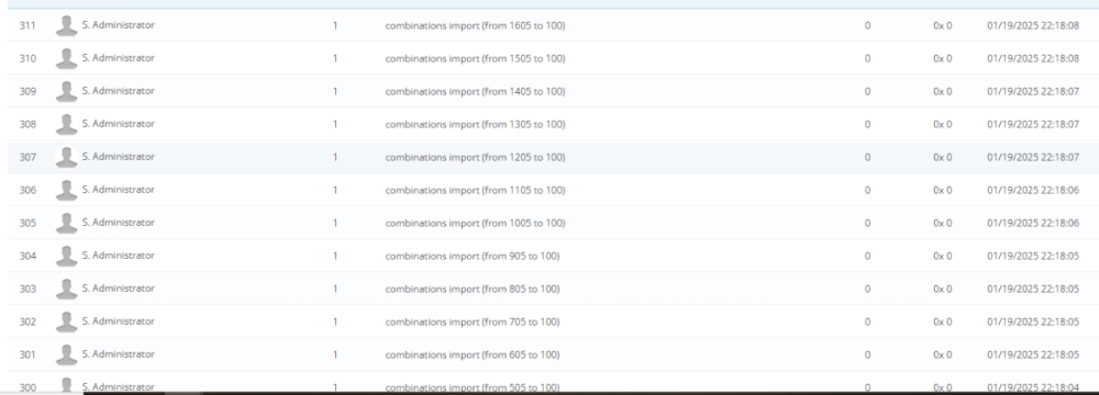

Logger says only:
Quotes don't help - the values get imported with them in the store (when the import succeeds).
I managed to import few combinations but only if the file is very small (under 20 rows or so). I see that large files are split in multiple parts that are imported by ajax but I can't figure out what is breaking. So I looked at my file and found a row where a product had only color but not size associated with it (no stock is available). An easy fix - python script will exclude those and give me a list to remove them from my store.
But then when I try to import the file without those unproperly formatted lines I get this error:
And once again - if I make the file very small (~20 lines) it imports, but if I have 2k lines - this error appears...
