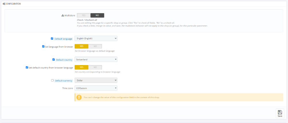

Is there an option to set a default country without coding?

Regarding the default country you can set this here Localization->Localization:
