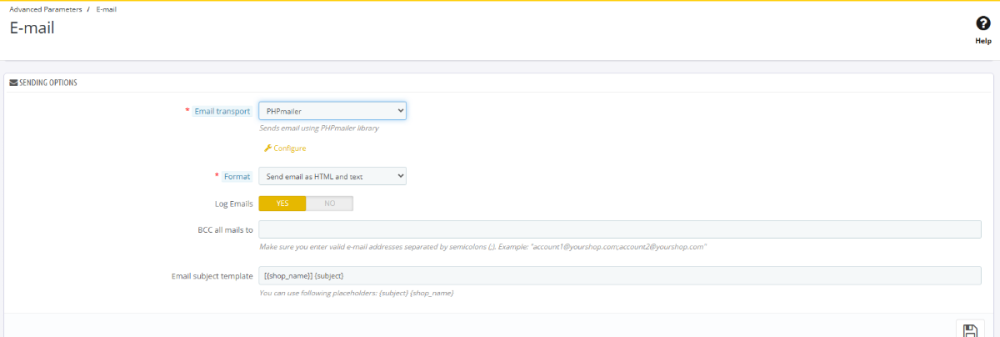

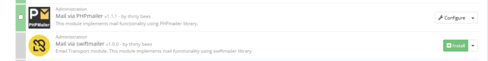

1. Did you install a mail transport module when under thirtybees 1.6? This functionality was moved to a module so different methods can be used (the one in PS and thirty bees up until now was unmaintained and obstructed further development of the system). After you install your module and configure it you should also select it for use in Advanced Preferences->Email:
image.thumb.png.b43d0efae18b2f8b4558cf5bf3da8485.png2. If you have migrated your old table to a fresh 1.6 install the order state ids might be different. This is not thirty bees fault, it introduces some default states but this configuration might be modified by each shop and this approach is not recommended when updating. If you use Core Updater this will not be the case.
