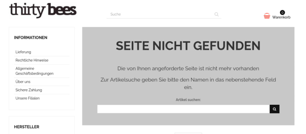

nickz Posted 20 hours ago Posted 20 hours ago (edited) I just uploaded a recent download TB1.6. It only installed to a brand new DataBase not a renamed one or even an empty one. Upon install I get a page not found and no admin, Shop is the same picture. Shop is in German, no Demo Pictures, Php is se t to 8. I've disabled webservice no changes, Anyone has an idea? Edited 19 hours ago by nickz
the.rampage.rado Posted 19 hours ago Posted 19 hours ago What do you mean by 'installed to a brand new database'? If you run the installer, it should always be in new db. Sounds like the installer choked somewhere and did not complete the install. Did you use Softaculus or a clean download from the site? Did you try the other option?

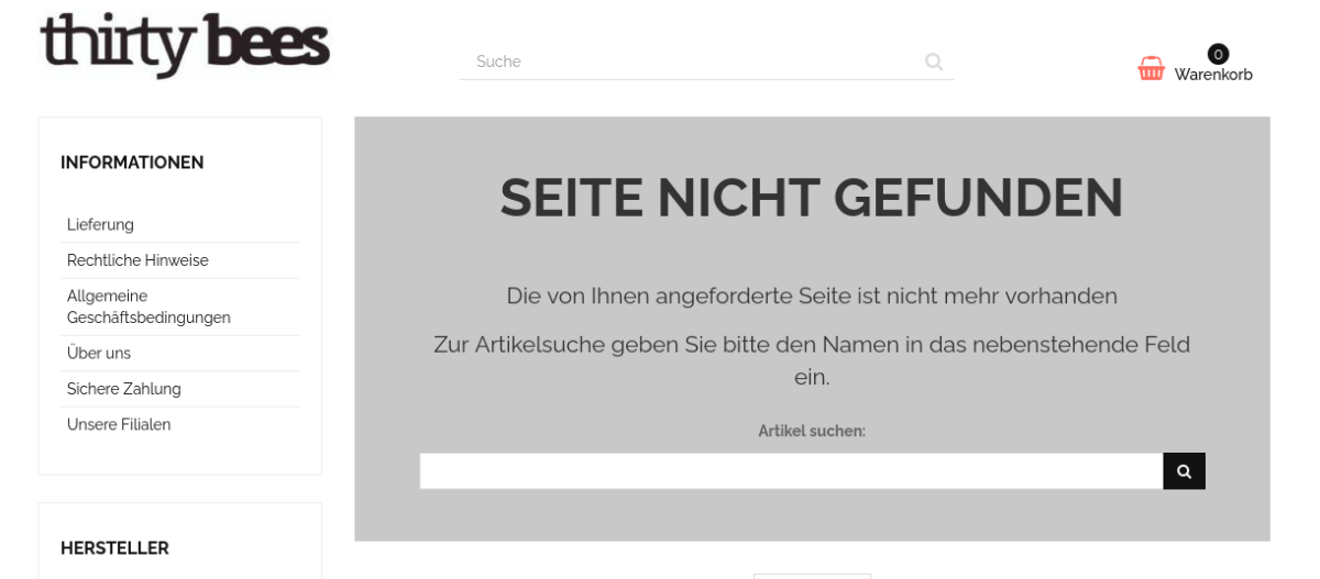

nickz Posted 18 hours ago Author Posted 18 hours ago (edited) 35 minutes ago, the.rampage.rado said: Sounds like the installer choked somewhere and did not complete the install. Did you use Softaculus or a clean download from the site? Did you try the other option? Both experiments came to the same end. Page not shown on, 1st Intend the clean download, uploaded to a folder and installing to a brand new database as 2 other DB where not found, or not good enough. Result: a greyed out filed with Admin page not found, Meaning instead of the admin login, a greyed out area saying page not found. Shop Url Page not found. Similar result. After deleting everything I tried a Softaculus approach, with the exact same results. Edited 18 hours ago by nickz
nickz Posted 18 hours ago Author Posted 18 hours ago I used now TB 1.5 and adding the index.php to the admin folders name did reveal the login page. With TB1.6 that did not work.
the.rampage.rado Posted 16 hours ago Posted 16 hours ago You should always have index.php in every folder. This is not a fix. Something is breaking the installer. Did you have a running install on this setup before?
nickz Posted 3 hours ago Author Posted 3 hours ago 13 hours ago, the.rampage.rado said: You should always have index.php in every folder. This is not a fix I added the name files name: index.php, into the URL, Sorry if I was that unclear. Anyway the greyed not found issue is still present. 1.5 and 1.6 are displaying a similar behavior.
the.rampage.rado Posted 9 minutes ago Posted 9 minutes ago So now you have domain.com/admin/index.php and domain.com/index.php - and this is working but with domain.com/ and domain.com/admin/ it is not working? Then you do not have mod_rewrite active on the server, and you can't use 'pretty URLs' or Friendly URL as it's known in BO.
