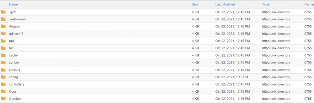

  13. The he/she means the core folder not the module. Jointsystems.org is up and running again now in 1.3. The 1.4 installation has been running well, so far, what are the main adavantages?
  14. You are correct, deleted cache/class_index.php and now jointsystem.org works. As far as "What does this mean?" I only deleted the core folder only and copied the core from the working 1.3. When that resulted in the TB installation not working I restored the original 1.2 core folder and the store is still down.
