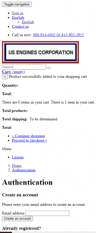

Updated three shops to 1.2 and now getting an index error at sign in on all three. The index displays fine when you open it but as soon as you click on sign in it loses its format.
