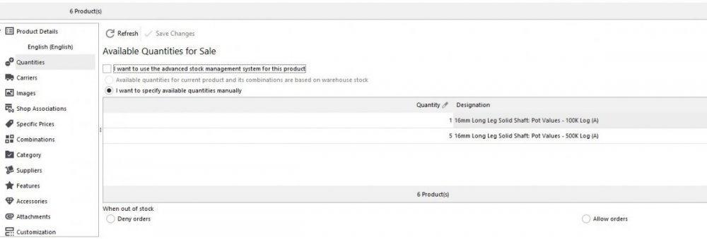

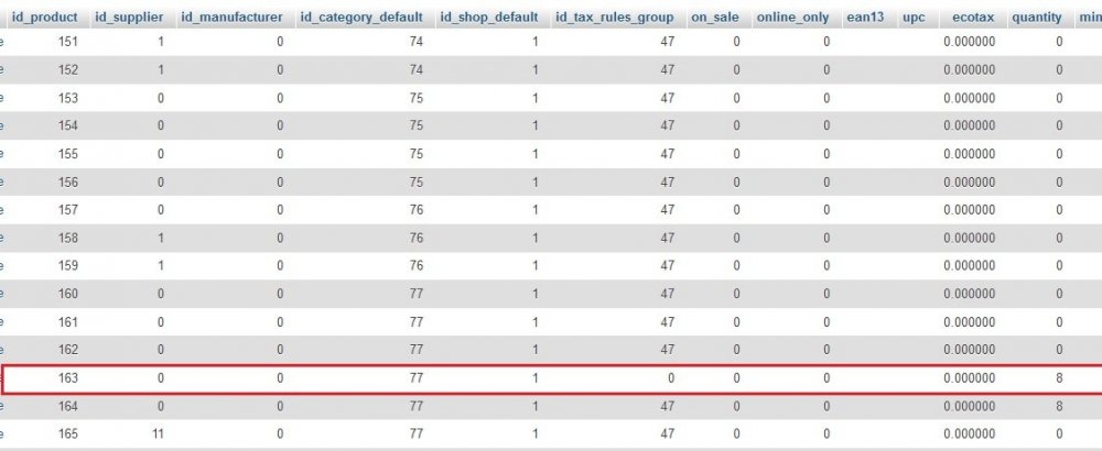

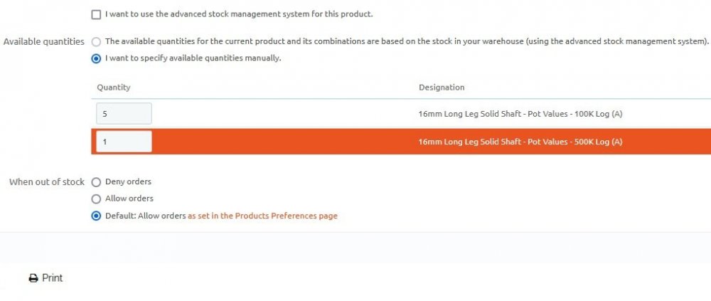

Now looking at the database for this product: https://griffineffects.com/parts/potentiometers-trimmers/16mm-long-leg-solid-shaft This product has 2 combinations. 100K Log (A) which has a quantity of 1 and 500K Log (A) which has a quantity of 5. This is correct on the front office/store thanks to Store Manager but they are showing swapped still in the stores backoffice. The database table under tb_products for this product a quantity of 8. Shouldn't it show 6? I'm thinking maybe this column is showing the original combination quantity I entered when creating the product because I entered 1 and 7 as quantity originally. I'm not seeing any column in tb_product_shop that is referencing any stock quantities but I'm comparing the columns with the two products that have the correct quantities shown in the front end to see if there are any differences and there aren't that I see. I honestly don't really know what I'm look at/for in tb_stock_available or really what most of the numbers mean. I found rows (shown below) with a product id of 163 (which is the product id of the product linked above). I don't know how to tell if the 1 and 5 are mixed up here or not. Also, all the product have that row with 0 id_product_attribute and the quantity column which seems to show a total quantity. Is this correct that it's supposed to be like this? id_stock_available id_product id_product_attribute id_shop id_shop_group quantity depends_on_stock out_of_stock 3567 162 0 1 0 90 0 1 3570 162 3408 1 0 25 0 1 3572 162 3410 1 0 25 0 1 3573 162 3411 1 0 16 0 1 3575 162 3413 1 0 24 0 1 3577 163 0 1 0 6 0 2 3584 163 3421 1 0 1 0 2 3585 163 3422 1 0 5 0 2
Ok. So I adjusted the quantities/stock of another product that had a few more combinations using Store Manager and it worked again so Store Manager is entering my stock correctly and making it show up in the store correctly but it still shows up in the store back office as mixed up. I attached pics of this other product which has 4 combinations. 100K W value is actually 16! So I just have to figure out why things are off when combinations are generated in the back office. Oooooh! I'm going to try and create a new product with combinations in Store Manager to see what happens!
Thanks for the tips and I'll look into all this. I am just so confused where the actual problem is now. The Store Manager app/program seems to connect only directly to the database and make changes there and this actually makes my stock quantities correct so I was leaning towards it not being a database problem and more of a back office problem. The thing that's throwing me is with Store Manager, quantities are correct on it and in the store/front end now but they are still showing mixed up in the back office. This leads me to think something is wrong in the back office and not the database but I'll check the database a little more to see what's going on there. Edit: Oh, and it's not that 1799 is not in the settings. It it actually is a quantity of another combination. Seems the combinations quantities are offset by 1 row. Meaning the quantity of the first combination is actually on the second row, the second combinations quantity is actually on the third row, etc. The last combinations quantity is moved up to the top row. So each quantity for each combination is in the row below it.

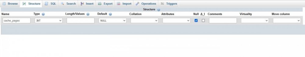

I'm trying to fix it but I really don't know how. Clicking the fix buttons on these don't do anything. I went to the database/mysql and to to them and I'm really not sure what to change (i.e. where to add the (11) or if there is anything else to change along with it). I don't know much about databases and their structure. Edit: For example, the first one on the list "Column tb_referrer_shop.cache_pages has data type int instead of int(11)" I assume I put 11 in the Length/Values field but it does nothing. Adding the () throws a error. Not really sure what to do here.

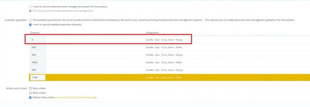

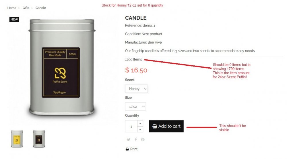

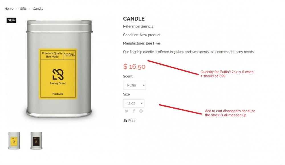

I've done 3 fresh installs of TB now and I'm getting the same result every time. This last time I did it in a brand new folder and checked install the demo stuff. The ONLY thing I've done is change the stock on one candle combo to 0 and it messes all the stock up just like I've been saying. Am I doing something wrong? I've been using Prestashop since 1.4 and run/maintain the shop myself so I kind of know what I'm doing but maybe there is something/some setting in TB that I need to change? Here is the Demo/Test shop product I changed the stock quantity: http://griffineffects.com/shop/gifts/candle#/1-size-12_oz/22-scent-honey The pic below shows I just changed the quantity of Candle-Size-12oz. Scent - Honey to 0 The below picture shows 12oz Honey has a quantity of 1799 (quantity is mixed up with 24oz/Puffin) and should be 0 and the Add to cart button is shown. Now the below picture shows 12oz/Puffin has 0 quantity and the Add to cart button is gone. This is mixed up with 12oz/Honey. So all the quantities are mixed up. Honey/12oz shows 1799 items when it should be 0 Honey/16oz shows 899 items when it should be 900 Honey/24oz shows 3600 items when it should be 900 Puffin/12oz shows 0 items when it should be 899 Puffin/16oz shows 900 items when it should be 3600 Puffin/24oz shows 900 items when it should be 1799 I've now done this 4 time total (1 with my own products and 3 with the demo products). Brand new database ever time. I've use Filezilla 2 times and by CPanel 2 times to upload the files. Same result every time. If this isn't a bug, what is going on? Brand new store. Nothing change but one quantity to 0 on demo item and stock gets all messed up.
I really need to get this fixed. I can't use this as it is. It's happening on all products with combinations that have mixed stock (some combos have stock and others don't) and deny orders is active. Even with Allow Orders selected the stock is backwards if one of the combinations is 0. I exported all products, installed a fresh TB, imported the products and it's still doing it. Can anyone help me???? I have a few other problems/issues with some other things too which happened in both installs of TB. The lack of help here is making me think of abandoning TB and going for something else. At least at Prestashop there were a lot of people that helped when I had a problem/question.

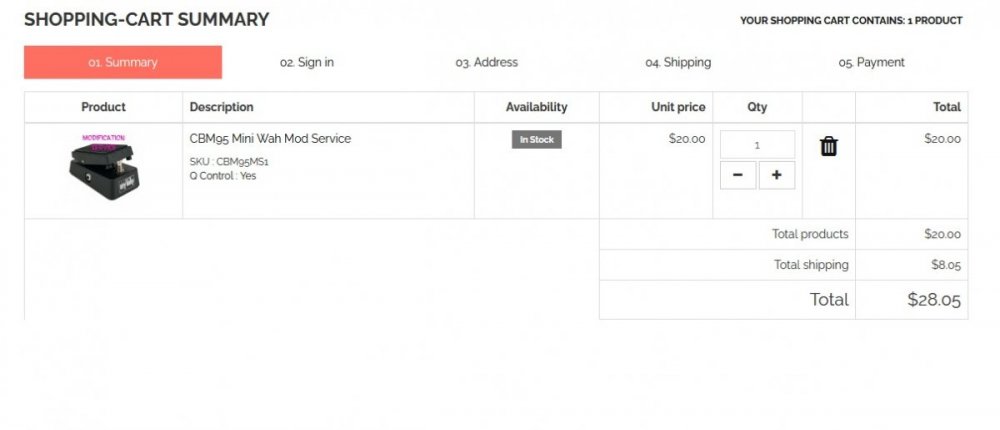

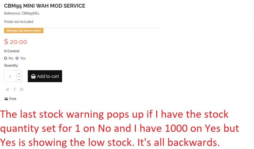

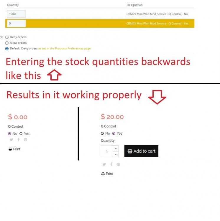

So what I think is happening is it's "reading" the attributes backwards. If I have the stock quantity of Yes to 1000 and set the stock quantity of No to 1, when I activate the Yes radio button on the product page, it says "Warning Last Items In Stock". If I set the quantity of Yes to 0 and the stock quantity of No to 1000, the product page radio buttons work exactly correct. I added the item to the cart and it shows up correctly. So the attributes are indeed working backwards.
